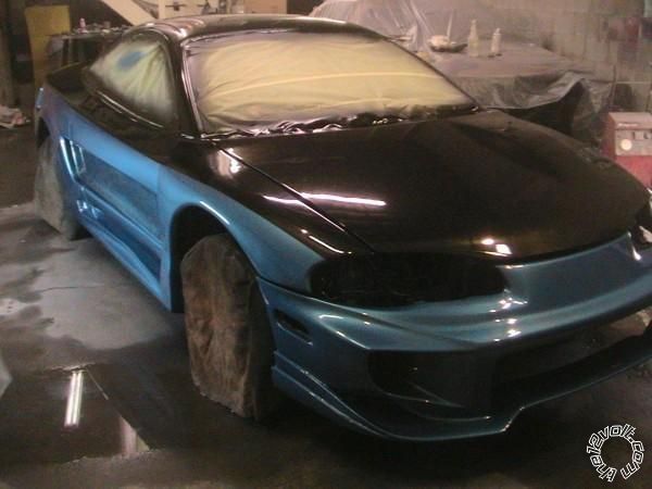

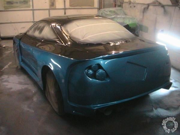

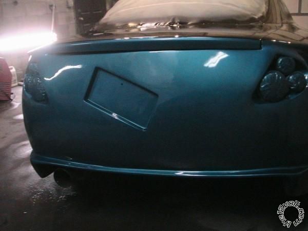

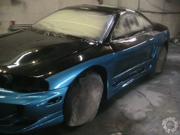

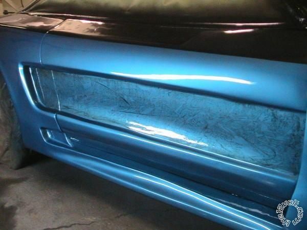

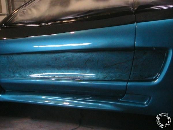

that is Nucking Futs that sub is HUGE. Im going to be happy if I hit 145db with my lethal injections. I am currently building the box for them and waiting to get the subs in. Hopefully going to have them in 2 weeks or so, I just got set back with some other things. Ill post some pictures when I get the interior done on the car. here is what the outside looks like now. and everything was done by me except for the paint, i did all the body work and everything. the interior use to look nice. haha not so much anymore. its all torn apart on the inside and I am redoing it. hopefully should be done in like 2 or 3 weeks.posted_image

If you need some help with enclosure design just let me know. Hope those extra body mods are done right and you deaden the car good to lessen flex. I would hate to see you redoing them.

yeah at first the were not done right, i tried to take the cheap way out, but it wasn't worth it. no bondo is on the car to hold it together, all evercoat tiger-hair and the good stuff haha. but they are now on good. i started by riveting them on, then i used tiger-hair to put it on, then v-grooved it, packed in about 5 coats for fg mat then used filler over that. and its on there pretty darn good, but i didn't use much dynamat at first, so now that i'm re-doing the interior, I am going to get another pack of dynamat and redo the hatch area and the floor and roof. I should be good after that. and I got box specs from Nick over at Incriminator Audio, so they should be pretty legit. Also, I do need some help on a box I am going to build. They are for 2 12" Lanzar MAX12D subs. Right now I have them in a prefab box because I had it laying around as an extra box and its a sealed box at 1.25cu.ft. per chamber, and its a dual chamber box. It hits pretty damn good in all honesty, I definitely was not expecting it to sound as good as it does. But I want to make it hit to its full potential, what size box would be good for these subs?
