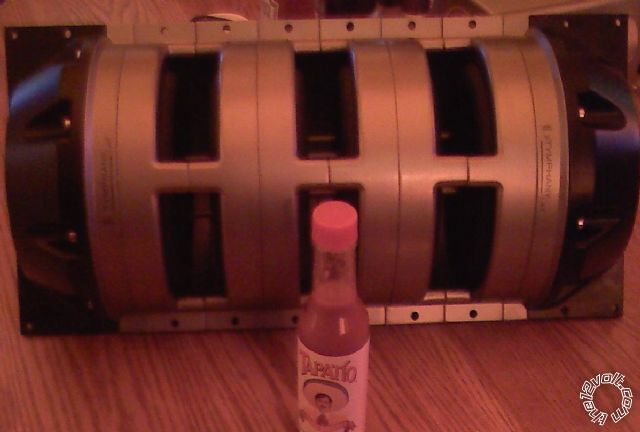

Well... They arrived last night! Freakin' MONSTERS! Small, and heavy... It always feels like I am working with parts that the earth seems to want... Really bad! Dave literally had dreams about them last night!
Picture taken with my cell phone, better pics will come along later! Note the size of the Tapatio bottle in front.
posted_image

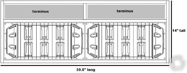

Up until about 2am, trying to figure a way to get the both of them in the trunk of my Civic!
Seems a TL is the best option.
What?
No, really!
Seriously, Dave? A TL?!?!
Was there EVER any doubt?
