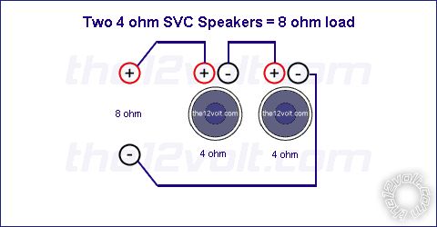

Your amp can handle a 2 ohm load. BUT only in stereo mode / 2 ohms to each channel. when you bridge it it can only handle a 4 ohm load because each channel can handle a 2 ohm load and 2 + 2 = 4 ohms bridged. so when you bridge the amp it divides the load to both channels.
This is the proper way to connect 2 SVC 4ohm speakers to a non- 1ohm stable 2ch amplifier bridged.
posted_image

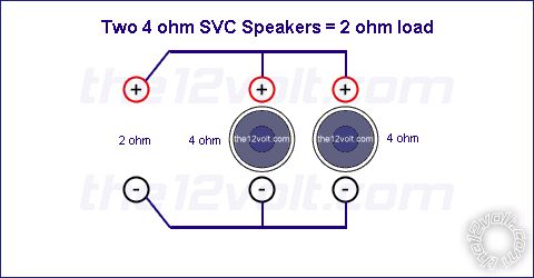

This is how to connect them to achieve a 2 ohm load that your amplifier is not rated to handle.
posted_image
