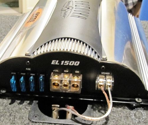

https://www.you tube.com/watch?v=MNp6KrGnsnw time - 5:50
I'm not saying to never use wire terminals ever, for instance if you want to be able to take just your box out easily; but if your on a budget like the OP seems to be on, why spend money on terminals. Just drill holes and 1) use less wire 2) fewer connections to worry about.
Why not just drill a hole were the wire needs to go instead of running them around the amp.

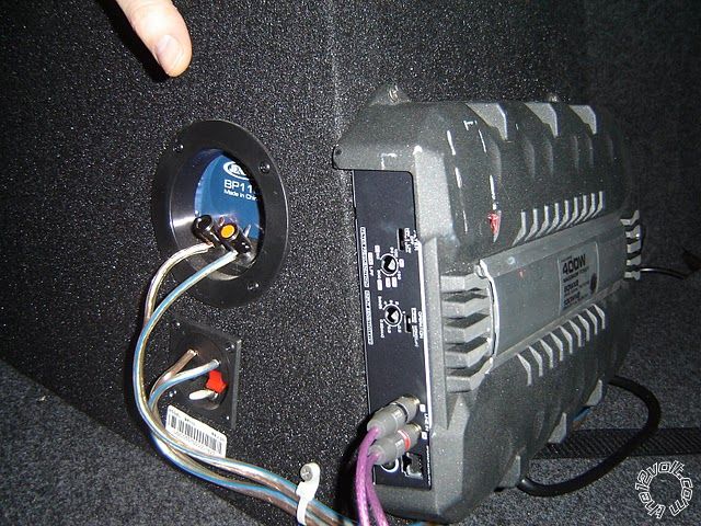

posted_image
Again why not just drill a neat little hole.
posted_image
My main point for this post is what do you get for the money you spend on a terminal and sealant? Arguable aesthetics? It certainly doesn't improve sound quality or anything.
Just my thoughts though and I thought it was viable in this situation.
