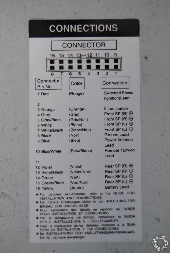

ok then... So what is the best way of doing it... if i'm gonna let the shop do it, it will cost me a lot... So I have decided to do it myself with your help ofcourse, in that case, if i'm gonna change it again, then i will know what to do... I'm attaching the cable codes of the new one (Alpine), just in case u will ask...

Date Posted: May 31, 2010 at 10:41 PM
Connect the radio's black wire to the Car's BLACK/ Green wire.

Ok, if i connect the radios black wire to black green wire, what about the car's black wire, where will i connect it on the radio's wire?..

Ok, I trid connectiong the car's black wire to the stereo's BLACK/ green. Still doesn't work...
