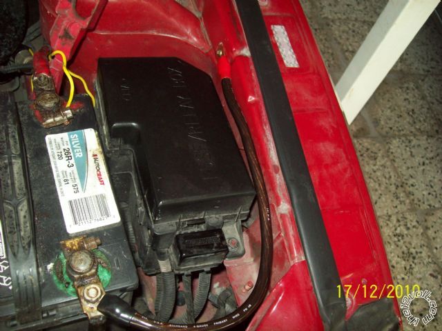

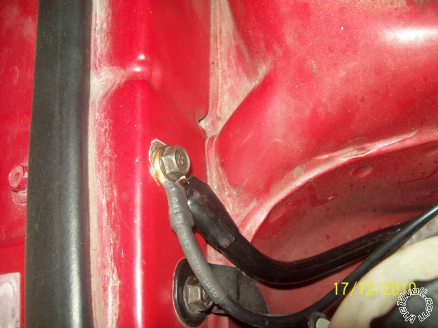

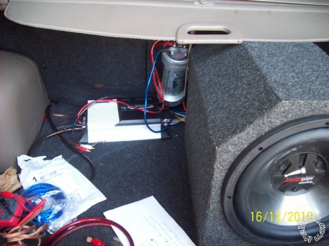

At last I changed the radio for a Kenwood Excelon 494. So I decided to try somethings I learned in the car audio forums and I upgraded two of the Big3 cables first was the block to chassis ground and then battery to chassis. I used 4gauge since my system is not a ground pounder monster but to my surprise the capacitor's voltage reading always was at 12.6 to 13.5 and now it is at 14.3!!!!. The radio is not shutting down anymore and the sub amp is hitting so hard I got to turn down the gains a little since the sub is just an audiopipe 12" in a ported box. It sounds like a 15" posted_image . I will post photos soon to show the horrible install I got right know and how i looks when finished.
She likes 33hz
Posted By: jaysonjota
Date Posted: December 17, 2010 at 10:27 AM
posted_image this is embarrasing posted_image but what else is gonna be better when finished you'll see.
posted_image Battery to chassis PLEASE if i'm doing something wrong tell me so I can fix it. Don't tell me it looks ugly I know that posted_image
posted_image Block to chassis lets see that and at bare metal posted_image

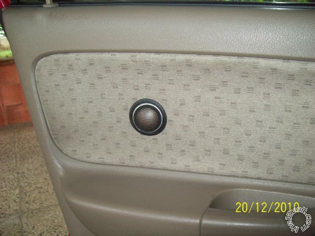

Date Posted: December 21, 2010 at 9:04 AM
Well as I said new photos of the radio and the components also I changed the 12" because it burned posted_image . The mono amp is hitting hard despite is just a cheap boss 1500. Check the photos.

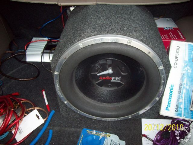

15" Audiopipe this takes everything I got. I raised the gain and she just stays like it ain't nothing posted_image but then agai is just a cheap boss 1500. It says 500rms 2ohm but I think is more like 235rms posted_image
posted_image

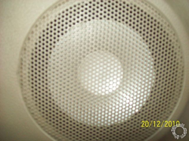

Now this is my babies components Infinity Reference posted_image I love them. They are back from 2003 and have travel through 3 cars with me. They still hit unequal. I will only change them for kappa or perfect components.
posted_image
posted_image

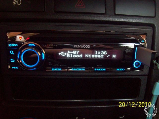

Here it is Kenwood KDCX494 this unit is excellent maybe better than expected and with 4v preouts my amp is hitting hard and the incoming highs amp will hit harder. Just can't wait.
posted_image
looks good see ya soon with an update at the mess LOL!!!!!!

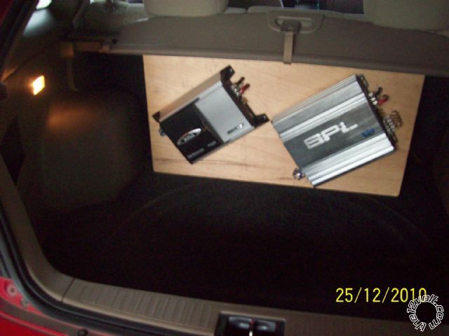

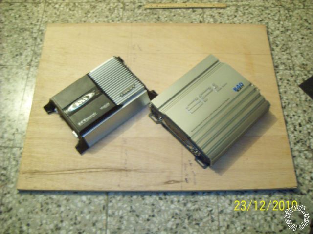

Date Posted: December 25, 2010 at 7:22 PM

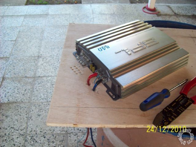

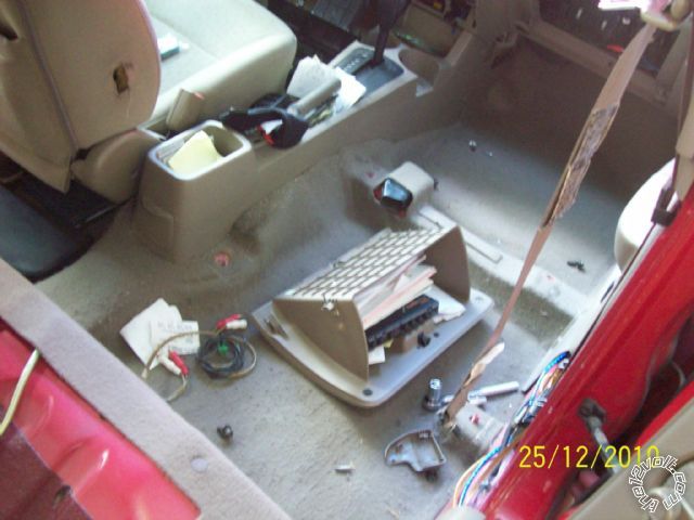

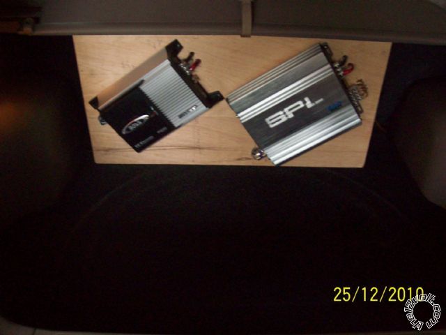

Well again here with the mess !!!!! Yeah check this out posted_image
posted_image

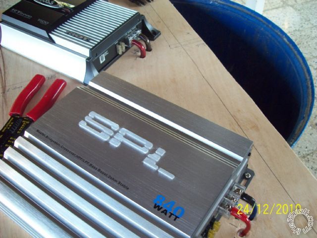

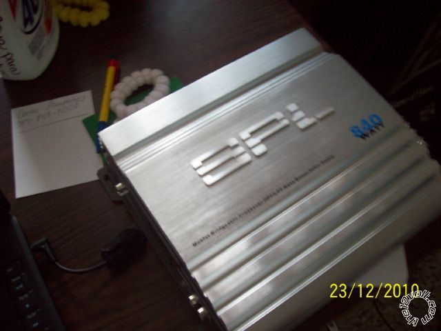

Amp for the highs SPL4840 it hits good but not awesome, unexpected posted_image
posted_image
posted_image
posted_image
posted_image
posted_image
posted_image

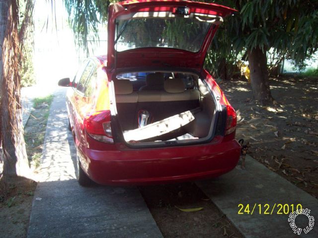

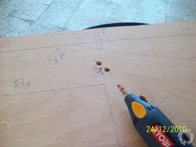

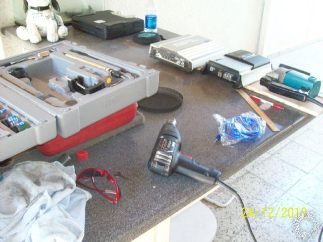

More mess!!!
posted_image posted_image

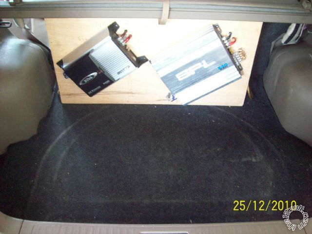

And the mess is gone...
posted_imageposted_image
Next will be cover the wood and both sides to clean the look. Is a simple install but I like to keep it simple.
