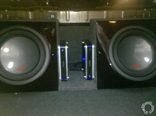

posted_image
This one, except with the 1223D. Also, another PDX 1.600 stacked on top. I just wish it was easier to set my gains without having to rip everything out. This was my first box. Never again will I do miter cuts on all joints "just for fun".
Posted By: z03mz03m
Date Posted: December 26, 2010 at 3:14 PM
Why not mount one amp on either side with the controls facing out?
It looks good BTW. posted_image

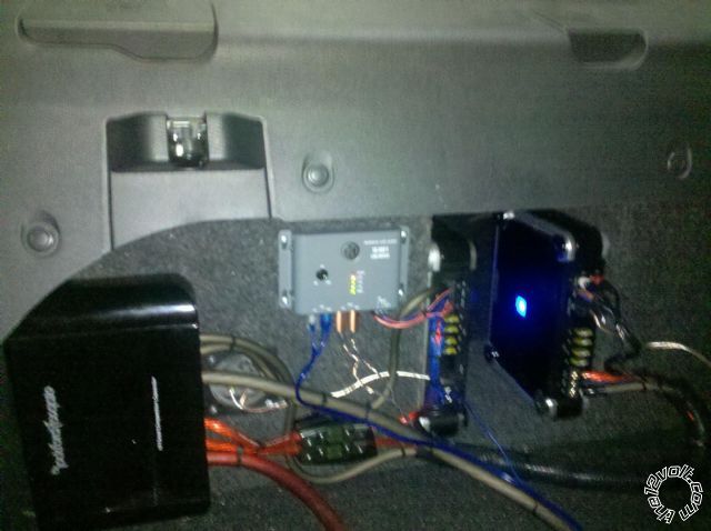

Posted By: ice6
Date Posted: January 07, 2011 at 9:04 AM
posted_image
posted_image
You'd think a 5 MP camera would take better pics.
Posted By: z03mz03m
Date Posted: January 07, 2011 at 10:00 AM
It looks good though. It looks like your camera needed more light. What's the rockford, a cap?
Dodge Magnum in progress:
Posted By: ice6
Date Posted: January 07, 2011 at 12:03 PM
A 10 Farad digital cap. I've got a yellow top up front and still had a bit of dimming. The cap worked nicely for the voltage drop and power distro.
