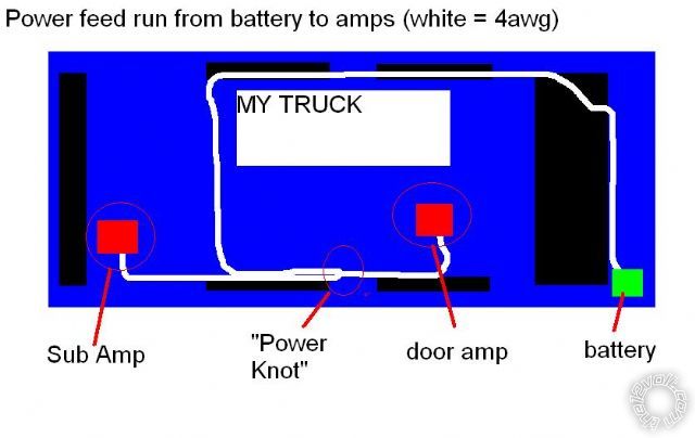

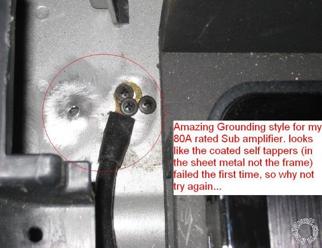

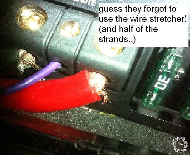

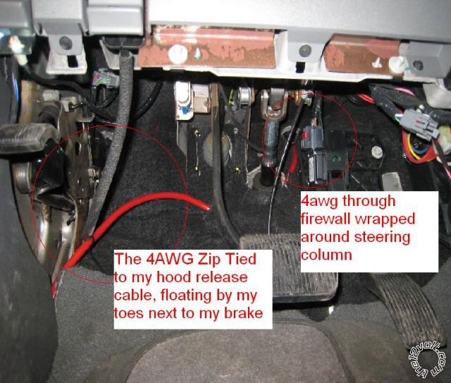

For power: they ran 4AWG from battery hot to inside dash in car, split to 4AWG to each amp. they used the same 4AWG from the amps to chassis ground. they did NOT upgrade the chassis ground wire from the battery, which from the factory is still 10AWG. inline with the 4AWG from the battery to amps, they installed a 250A wafer fuse in a fuse holder which they installed right under the hinge of my hood, which now does not close fully. also by installing the base of the fuse holder where they did, the lifted the left side of the bezel that seals the engine compartment from the hood to keep out water, breaking the seal.
Speakers: they used 12AWG speaker wire from amp to sub, but for door speakers, they ran the same 12AWG from the 4 channel amp to the crossovers (which they didnt mount, but threw behind my headlight switch just flopping around by the wires). from the crossovers in the dash, they went 12AWG to the tweeters directly, and then 12 AWG from the crossovers to the stock speaker wires from the factory harness, connecting them to the factory speaker wires with a drop of solder and a few twists of tape, using the stock wires in the doors for the woofers from the KRX2 Focal set.

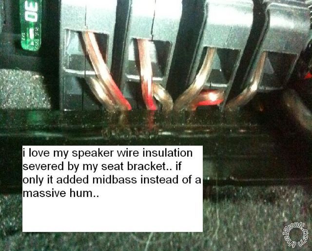

Lastly, for some reason, i have a nasty engine noise coming out of only ONE speaker (the pass rear door), the rest are clean. when i went to check the connections on the amp, i couldnt because they mounted the amp too far foward and then jammed the seat back in, crushing most of the wires on the connection side of the amp with the front rail of the seat. i have a feeling this has something to do with my engine noise, but havent had time to diagnose yet.

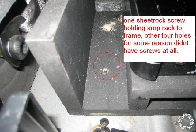

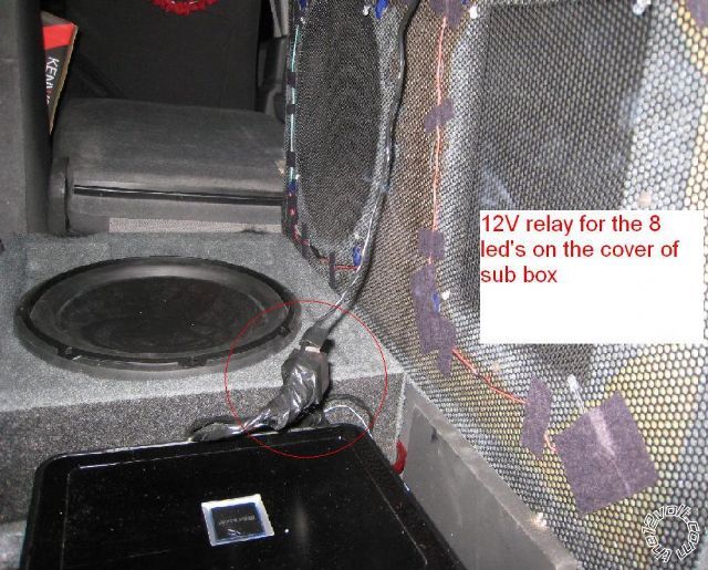

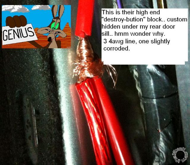

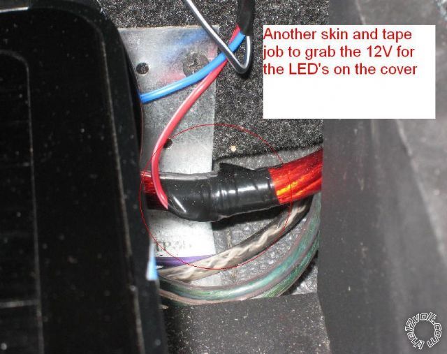

Hey guys, well here are the pictures i have so far. ill try to get more of the speaker and door wiring and how the crossovers and my sirius receiver are just thrown hanging by the wires behind the dash when i take the dash apart again another day, too cold out. this will pretty much give you an idea though. they are pretty self explanitory. i also added another hand drawing (sorry its kinda crappy i used paint) to illustrate the means in which they got power from the battery to the amps, using about 15 feet of extra 4awg than neccessary. anyway cant wait to hear what you have to say now, ill be back with more updates later, any questions let me know!

this has to be a joke! wow man thats not cool at all. I'm in disbelief that anyone could possibly think that they could charge that much for that work and not expect to be called on it! posted_image

wow im sorry to hear all that, i saw wiring and that looks like a fire hazard,... tell them your dealership wants to charge you to properly remove and that your lawyer will be contacting them! hehe see what they say, then ask if the techs are certified and properly trained.

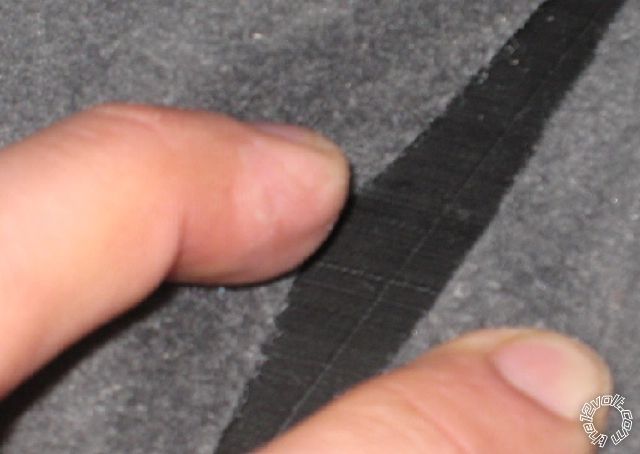

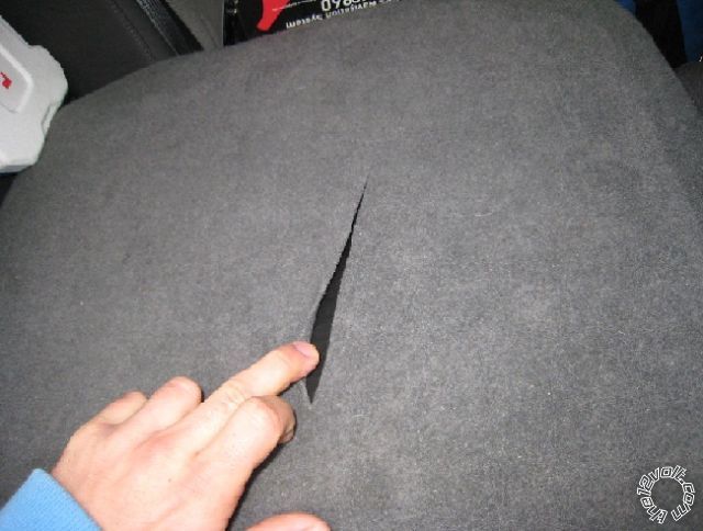

On a side note though, it just keeps getting better and better for my truck. I went to throw some equipment for work in the car by putting the back seat down and found another thing they did. It looks like they couldnt find a better place to cut the carpeting for my sub enclosure that they built than RIGHT ON MY BACK SEAT... they completely slashed the back of my seat, including digging into the plastic, so they must have been pressing hard with nothing under it. Im so angry at this point that slashing tires sounds better than talking to them, but of course im not going to do that.. i can fantasize cant i haha? it looks like ill have a hole at work tomorrow afternoon so im def making sure i get there... i cant hold it in anymore. anyway here are the pics of my seat slashed for your enjoyment... ill update you guys as soon as i know whats going on..posted_image

so, just a random slash in the back of your seat? no purpose at all? jeez! personally i think one of their installers, or maybe all of them, might not have gotten their morning crack fix.

I would be getting a full refund or court would be my next step. Very sorry to see such poor/dangerous work actually being charged for. 4 gauge is only rated to handle 150A safely so that 250A fuse is already got you in a major safety issue. let alone the nice spliced power wires!..... Yikes
