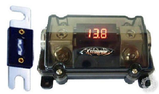

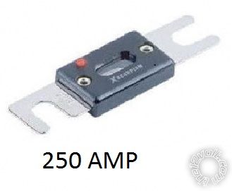

Date Posted: January 22, 2012 at 6:43 AM
Grabbed this: https://www..au/itm/270889784863?ssPageName=STRK:MEWNX:IT&_trksid=p3984.m1439.l2649
posted_image
And these: https://www..au/itm/400269204080?ssPageName=STRK:MEWNX:IT&_trksid=p3984.m1439.l2649
posted_image

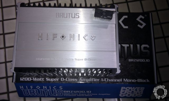

Amplifier arrived this morning.
posted_image

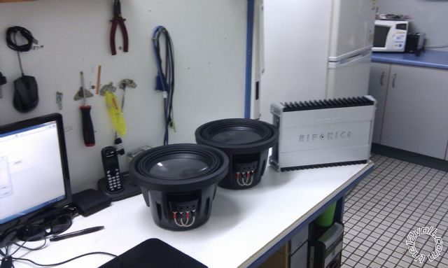

Posted By: equilibrium1990
Date Posted: January 23, 2012 at 7:56 PM
Scratch that, Subs are here also :-D
posted_image
Date Posted: January 26, 2012 at 6:48 AM
Fired up the Hifonics with a PC Power supply just to make sure she runs after freight and admittedly to see the lights haha
posted_image
posted_image
