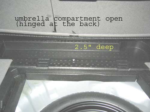

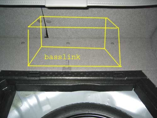

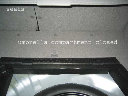

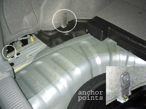

I have been doing a lot of thinking and I pulled the trunk of my subaru wagon apart to see what was there.
I will be opening the hatch in normal use of the car after I have installed the basslink, at some point I may also want to temporarily remove the basslink (depending on mounting location) to utilize all the space
It seems like I have 3 options to mount the sub, I don't know which may be the better and which may be stupid.
1) I can mount the sub using screws through the foam or into the foam.
2) Using pre exisiting anchor bolts (which are attached to car body) in the left side of the trunk, fabricate an MDF platform and attach sub to platform with 1/2" screws
3) Mount a piece of wood, underneath the umbrella compartment, screw the sub through the carpet to the wood.
I will enclose some photo's and it would be great if you can tell me if I am loosing my marbles :) thanks

Posted By: Ludecrous
Date Posted: May 03, 2003 at 7:55 AM
Date Posted: May 03, 2003 at 7:57 AM
USING EXISTING Anchor bolts to create a platform, using 90 degree brackets

Posted By: bberman1
Date Posted: May 03, 2003 at 9:57 AM
Wow those were some good photos, now I know where you’re coming from. And no you’re not going crazy you’re actually headed in the right direction. The way I would suggest doing it is your # 3 option, mounting a piece of MDF under the panel and then fastening the basslink through the panel and into the MDF. When you cut and mount the MDF just be sure to check and see if the hatch will still open and close before screwing them together. The only problem I could see with this is the umbrella compartments top panel might vibrate with the bass and you may need to fasten it down with Velcro. But I would defiantly try option 3 and see how it goes; I defiantly think it’s a winner.
