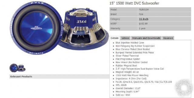

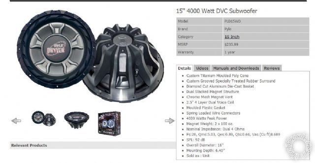

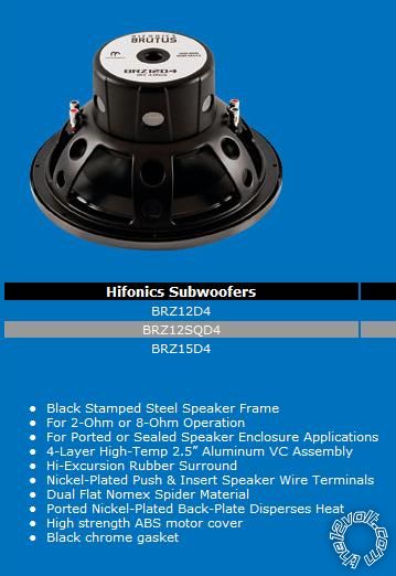

So as I try to understand this "miss-leading" advertising, what would be the issue with say, these 3 subs over a noted "good" brand? would it be longevity, sound, distortion?
posted_image
posted_image
posted_image
I am just trying to understand this,
I mean Rockford Fosgate is good right? comparable to JL?
I want to make sure I completely understand before I buy anything else

LOL! I'm thinking of my old rule - if they don't quote Watts RMS, stay away. (What's 1500W Max? 750W RMS? 375W RMS? Or some "arbitrary" factor?)

I hear good things about those cheap Hifonics subs.
The only negative I hear is the basket is so thin that if you aren't careful when you mount them, they can bend.

basically what it boils down to is materials and craftsmanship, honestly rated specs, durability under stress, and personally i think looks is another category. and looks works the opposite of how you think it would because usually the more basic design with the least frills ends up being the better product. if you have to chrome plate the whole sub just to sell it then it probably is a POS. better materials = better rubber, better glue, properly engineered voice coil, stronger cone material ( not just a stronger shape thats made from cheap material) and these are all things that you usually cant see with your eyes but you see it in the price. and honestly rated specs is a big one too. that 1500 watt MAX POWER!!!!! subwoofer is probably 300 rms and these are the only specs they usually will give you because the company doesnt care enough to inform the customer so they can use their product propperly. this is because they know that in most cases their product will break anyway so why give them any real specs because they are just looking to make a quick buck and move on. and the other spec they will usually give you is efficency because it is a commonly missunderstood spec and they label this spec "SPL" to make it even more missleading. they use to make you believe that one sub will be louder than the other because it has more DB and more Watts so it must be better, right?
