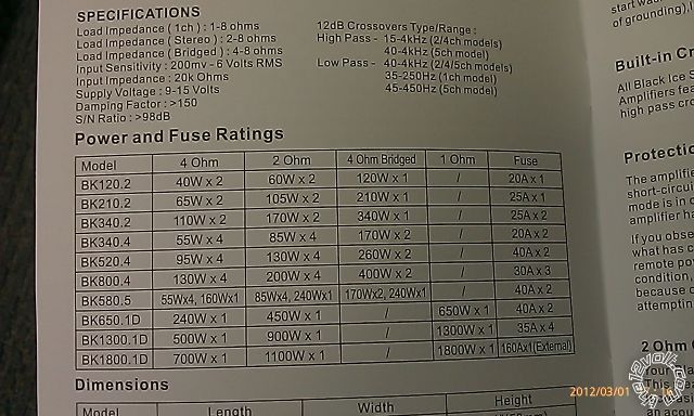

well im having some technical difficulties with the pictures since i cant find my data cable for my phone right now but i can give you a basic rundown of what i can see:
amp weighs about 15 pounds
no fuses on the amp but the manual calls for a 160A fuse on the main power wire

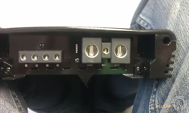

amp has 0g power terminals, which is crazy considering its only supposed to be an 1800W amp, but if you do the math it should do at least 2000W at 1 ohm at 14 volts depending on the efficiency of the power supply. opperating voltage is listed as 9 - 15 volts
it has a damping fatctor of >150 but it does not give me a spec for THD which is strange because the manual is for every amp in this series including the 2 and 4 channels so they wont give you a thd for any of their amps which seems kind of fishy to me. their high amps are compatible with their balanced line transmitter.

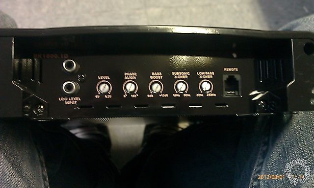

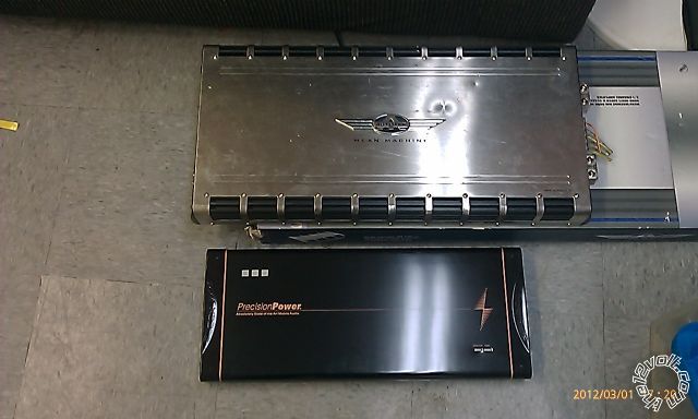

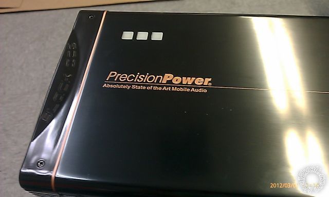

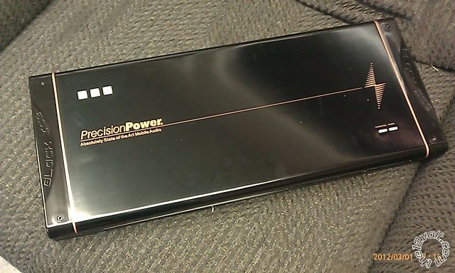

ok here are the pictures as promised.
as far as i can tell it has very good build quality. nothing is loose or cheap feeling. i sold this one to a friend in need today so i had the chance to hook it up to a RE audio SXX12 and it sounded way better than the kenwood amp that it replaced. it was an older kenwood 600W amp so nothing spectacular there but this amp did sound a lot better and obviously pushed a lot harder.
the picture of the PPI next to an autotek MM4000.1D is just to give you an overall idea of how big the amp is. keep in mind that it is the autotek 4000, not the 2000, and the difference in size isnt even that much.
i have another amp on the way now so i cant wait to hook it up to my SXX15 because it should be a really nice combo with the right box ofcourse.
