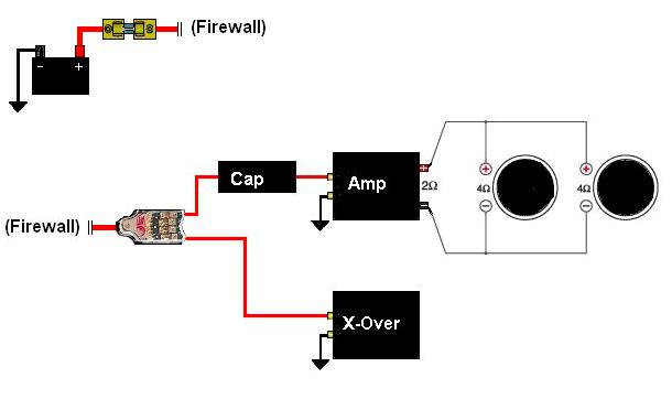

wvsquirrel if you get a chance can you draw me out a diagram for the power system wiring diagram as well as the subs.... i would really appreciate it as i am new to this game(with high power stuff any ways)

Date Posted: May 17, 2003 at 1:30 AM
I don't know the make/model of the X-Over so I didn't show the connections between the X-Over and the amp (I also didn't know what other speakers you were wiring into it).
The Cap looks like it has 2 positive terminals, but it really doesn't, I drew it like I did for continuity.
Hope this helps...

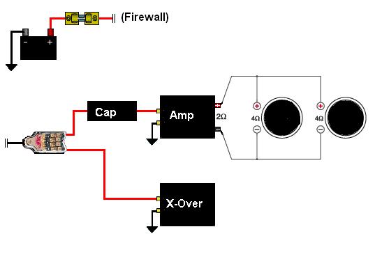

Posted By: wvsquirrel
Date Posted: May 17, 2003 at 1:38 AM
I can't edit my other post right now, so here's another shot (I had to edit the pic a little)...

Date Posted: May 17, 2003 at 10:52 AM
should i run the rca cables from the radio to the sub input on the xover then to the amp input??? is that right??? thanks for all the help squirrel!!!!!!!!!!!!!!!!!!!
Date Posted: May 17, 2003 at 10:59 PM
Yes, if you are planning on using the external crossover to control the signal going to the subs, then run the RCA's from the headunit to the crossover's input, then from the crossover's output the amplifier.
