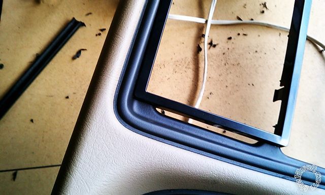

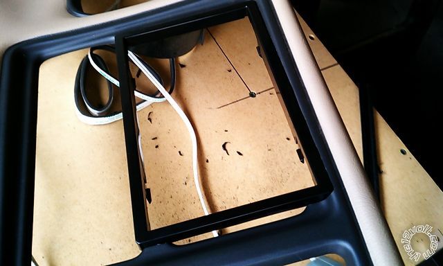

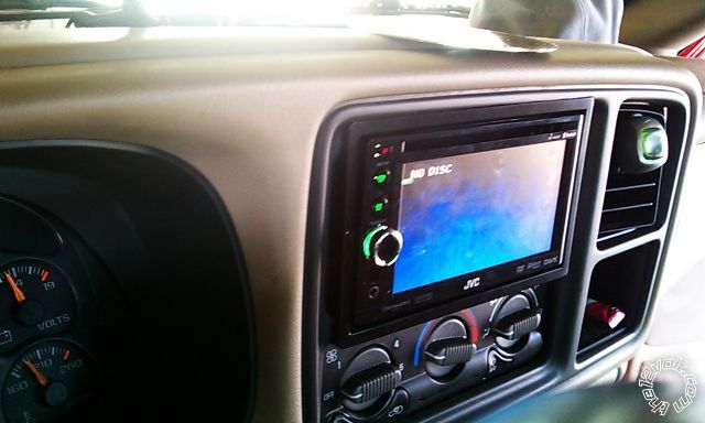

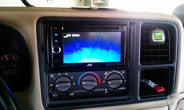

if you were interested, im actually doing a 2 Din install on an 03 silverado 2500 so i will post some pics of how i cut the dash for a JVC AV60BT. i cut the entire middle piece out and made the trim ring for the jvc sit even with where the bottom of that center bar would have been. then i traced and cut the shape of the top of the trim ring out of the top part of the dash so that the trim ring would sit flush with the dash. glued some flexible ABS in the gabs on each side and viola. i think it looks nice considering its a cut and paste operation but ill get the pics off of my phone you you guys can decide.

it may have been a 2002 model but i was told it was an 03. it was the radio with the side brackets that clip in without screws. anyway here are the promised pics.
posted_image
posted_image
posted_image
posted_image
i cut the hole in the trim the exact size of the radio trim ring so that i could make it sit flush with the dash. the cut is as close to perfect as it will ever get using a cutoff wheel and a dremmel but i used some sticky-backed foam strip on top just to eliminate any possible light gap. in addition to cutting the trim, i also had to cut out a metal brace and a bunch of plastic from behind the radio just so the new tv will fit. i used cheese strap to mount it using two factory screws, but i could have used the dash kit bracket clips if i had more time to get the spacing and angle the way it needed to be.
