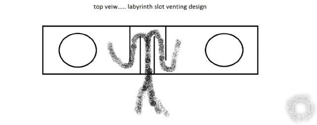

k i will try that. but just for thoughts what bout this designposted_image
Posted By: DYohn
Date Posted: September 07, 2012 at 3:49 PM
That sort of design can work well, but in your case the enclosure is already too small so adding that sort of vent would only make it smaller and more boomy.  Unless yu can double your enclosure size, I can't recommend it in your case.

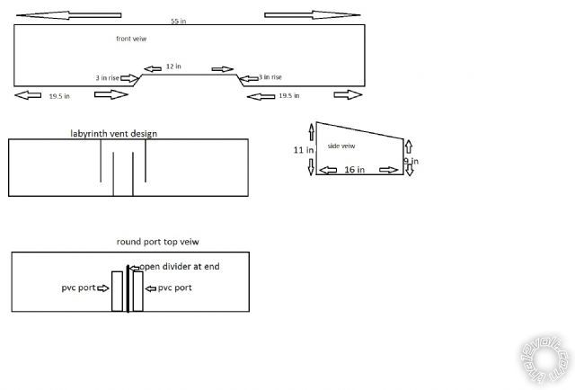

ok let me start over. im going to be raising my rear seat up 2in. that will give me 55"long x 16"deep x 11"tall(front)and 9"tall(back). heres the new dimensionsposted_image.
i would like to do the labyrinth version if possible but if not what bout the round port version with 2 ports and a 1/4 open divider. let me know what you think. and sorry for all the bs
Posted By: DYohn
Date Posted: September 08, 2012 at 11:23 AM
You can't just put any old labyrinth (AKA slot port) or port tube into a system.  You have to design it for a particular length and volume to tune the enclosure at the desired frequency.  For your woofers, to get any sub bass at all out of them, you have to tune very low, like 21Hz.  Do some calculations and figure out what that means your port length needs to be for the size of your enclosure and the size of the opening you plan to build.
