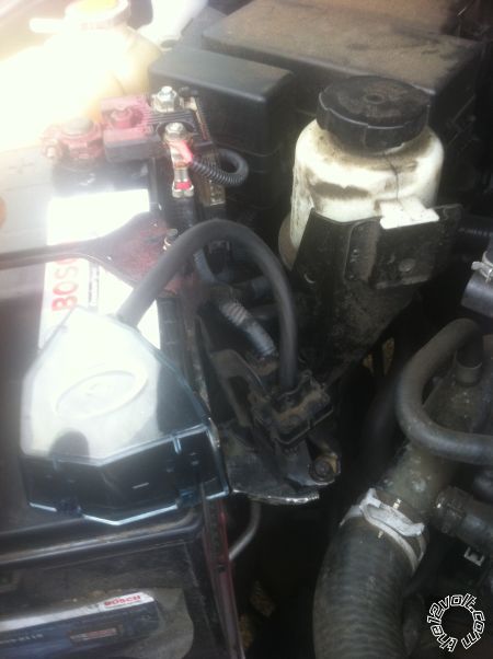

Doing the the BIG 3 upgrade for a 2007 Nissan Pathfinder V6 LE. I just placed my order from Ohio Gen for a 300amp monster with 100 to 125 Amps output at 1000RPM. Will put up the spec chart. Any advise would be greatly appreciated. This is my first Alt upgrade on a Nissan.

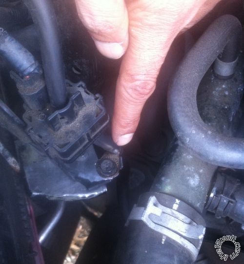

I was reading up and found out there is a ground-sensor relay on the side of the battery from the neg wire on the battery to the engine and that all the ground must go thru this sensor. So all ground point with have to be from the battery terminal? I will put up pic of the Ohio beast in a few days. Also for power/ground wires, does anyone have recommendations, I was was thing to go with Knukonceptz 1/0 AWG and 4 AWG all the way around.
The best tool in my work shop, is my BRAIN!!!!
Posted By: soundnsecurity
Date Posted: September 24, 2012 at 11:38 AM
if the ground has to go through the sensor then dont replace the factory ground, just add a 0 gauge ground to the frame and leave the factory ground alone. this is what i did in my 2011 frontier which is basically the same thing as your pathfinder, also ran knukonceptz 0g in mine too. i havent upgraded my alternator yet but i havent had a reason yet because the factory system keeps up with 1800 watt amp

THX for the info soundnsecurity.... its a crime to see the cheap doodie wire Nissan used on the ground. I know a 4awg will fit thru it, but after i remove the factory wire i will have a better idea. Looking at the factory wire it just seam to go thru the sensor and not connecting it in any way?
Ground-sensor on 2007 Pathfinder
My thinking was to replace it with a min of good quality 4awg or better and soldiered terminals. Also remove the paint under the bolt where the ground sensor is bolted down with a smaller 10awg ground wire going to the somewhere under the fuse box ( cause Nissan did the smart thing by grounding on top of the paint posted_image )
Where did you run the frame wire, to the engine ground or to the battery neg? Also did you have to run your amp ground from the neg battery term to the Amp?
Date Posted: September 24, 2012 at 10:00 PM
i grounded it to the frame right below the battery, nothing special except that i sanded down to bare metal and then i re-coated it with undercoating after i made the connections. i did not have to run the amp straight to the battery, if you did that then it would make no sense to upgrade the factory battery ground. i just made a solid connection close to the seatbelt bolt on the drivers side.

Okay here is what I have found out about Nissan's:
Variable voltage control system:
CAUTION:
- Do not ground accessories directly to the battery terminal. Doing so will bypass the variable voltage control system and the vehicle battery may not charge completely.
- Use electrical accessories with the engine running to avoid discharging the vehicle battery.
Your vehicle is equipped with a variable voltage control system. This system measures the amount of electrical discharge from the battery and controls voltage generated by the generator.
The current sensor (A) is located near the battery along the negative battery cable. If you add electrical accessories to your vehicle, be sure to ground them to a suitable body ground such as the frame or engine block area.
So the best thing to do is to swap the wire from the battery terminal to the engine ground and as soundnsecurity said use a heavy AWG to the engine ground to the chaise and ground everything to the frame.
Also stopped off at the Nissan dealer and spoke to a few mechanic's and they confirmed, that it doesn't matter the wire type and size, only that it need to pass thru the sensor and ground to the engine block.
One mechanic even told me that he upgraded his ground and it improved his idling & cold starts, had it for a year or so and no problem with the charging system to date.

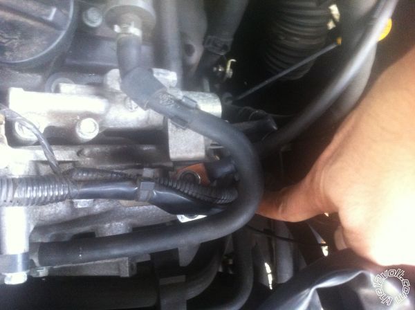

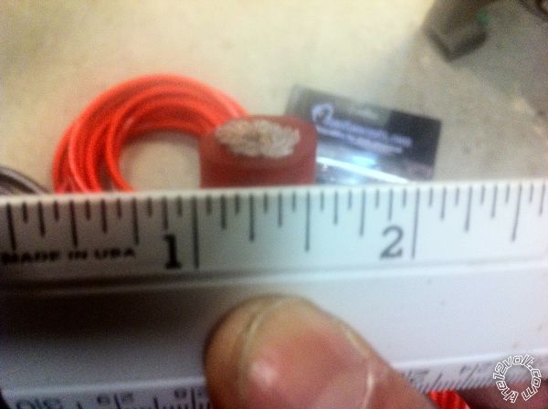

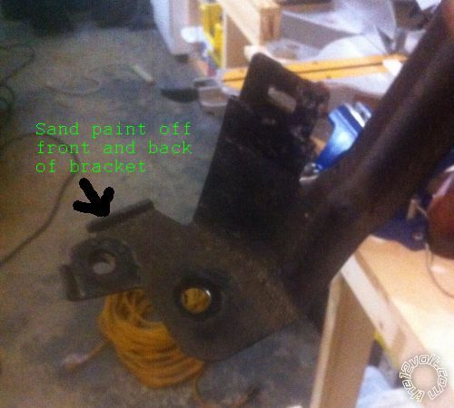

I replaced the factor ground with Knukonceptz Kolossus 4-awg. It was the best wire for the money that would fit in the thought the ground sensor. The sensor opening is 13mm so what ever wire you get it cant be larger then that.

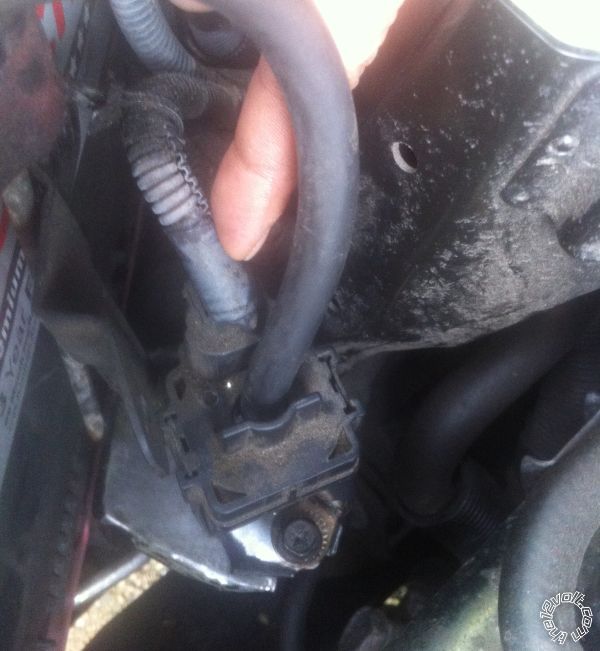

Removing the ground and sensor:
1) start by removing the ground on the battery and then the positive terminals, Put a duct tape over the positive terminal (i like to play it safe). remove the battery for better open work space.
2) remove the connector on top of the ground sensor( I used needle nose to press the clip).
Then the sensor from the metal bracket(slide it straight up... may need a little force).
3) remove the 10mm bolt connecting the middle ring terminal of the ground wire to the bracket. Last remove the bolt from the engine side of the wire.

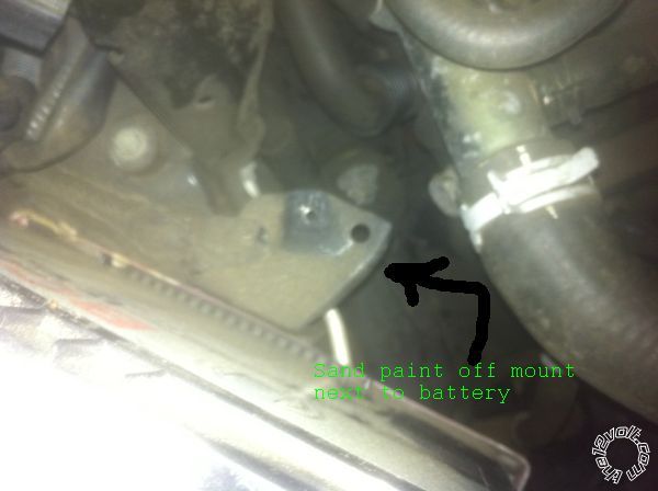

Remove the Paint and clean surfaces:
1) remove the 10mm bolt in the middle connecting the bracket.
2) sand the front and back of the bracket and the bottom plate of the area where the bracket sits on. Also sand and clean where the wire connects to the engine( i used a wire brush)
Make the wire.
1)Start by getting whole wire length on the new 4-awg. use the old wire for measurements. stripe and solder one end with a ring terminal and use heat shrink tubing.
2)next you will need to get a ring terminal that has a splice in the barrel so you can open it up to connect it in the middle. Crimp and then solder the middle terminal don't forget to slide in a hear shrink tube before you put the terminal on.
3) Next slide the sensor back on the wire before you put on the last ring terminal or in my case I change the battery terminal that use open end wire.
4)Finally connect it all back up in reverse order and you don't.
Now you have a solid ground from your battery to engine.

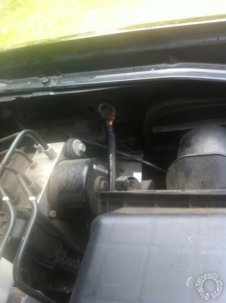

Upgraded the cheap 12awg ground from the engine block to the frame on the drivers side with 4awg. Next will be to upgrade with a 0awg to the Engine ground where the battery is also grounded to the main frame. Also will add a 0awg at the rear where the amp rack will be for the JL Audio 1-500/1 and 2-300/4 amps to the main frame on the driver-side.

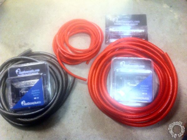

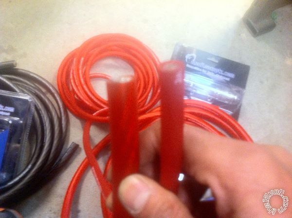

OK just received all the power and ground wires for the Alternator and amps. I love KnuKnoceptz wires. All ready at $600 just for the power, ground and RCA cables. As soon as it warms up in here i can do my Alt and power wire install.....
1/0 main power kolossus
1/0 and 4awg kolossus
