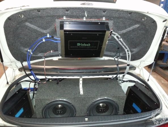

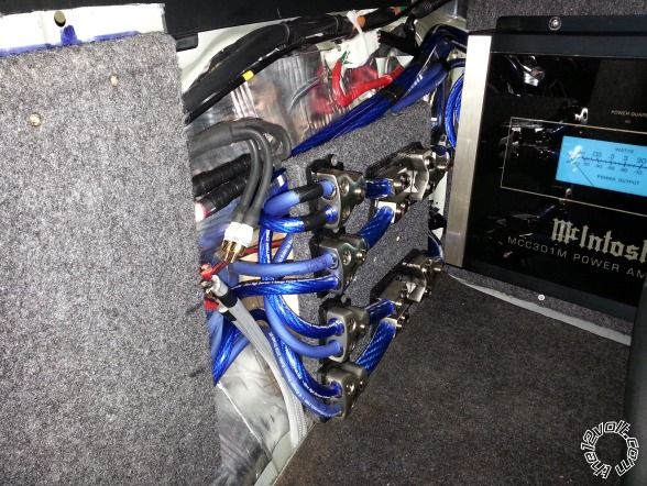

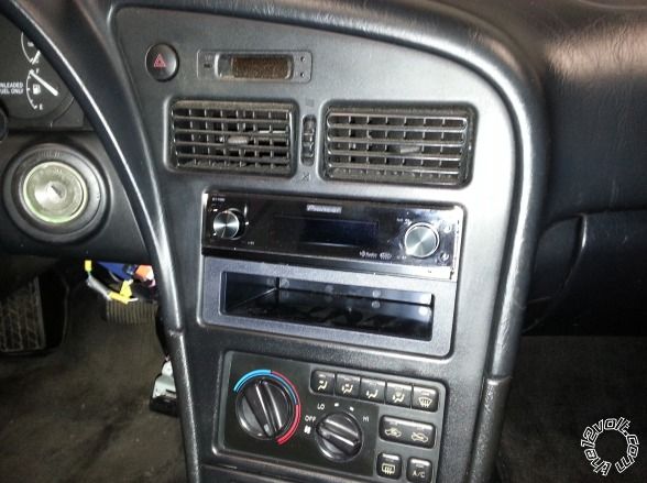

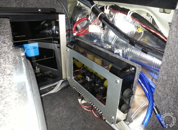

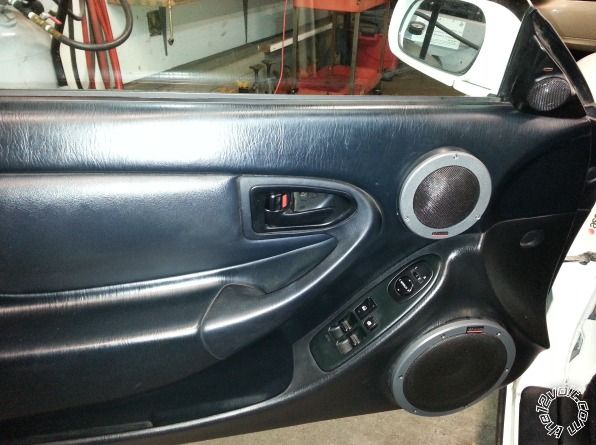

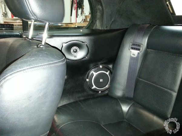

S&S, I'm almost done with the install. I'm waiting on 1 more MCC302. Here are some photos.
posted_imageposted_imageposted_imageposted_imageposted_imageposted_image
Don't know what the problem is yet... but I know what it's not.
Posted By: soundnsecurity
Date Posted: February 28, 2013 at 7:45 PM
that is a very interesting install. it must sound pretty nice already, that pioneer has a self tuning EQ doesnt it? or is it the older one that only had a stereo 16 band and you had to set it yourself? either way its a nice install...so many wires and distribution blocks. i really would have ran a dedicated wire to each amp instead of using distribution blocks. and then mounting an amp to the truck in my opinion is just not a smart idea for many reasons, one being that your ground has to be very long and the amp will be vibrated to death from being on the trunk lid with the bass hitting. if it was just a regular amp i wouldnt have said anything to you but im sure you would rather not lose an expensive amp for such a minor reason as being mounted to the trunk lid.
speakers look pretty insane too, are you running the front as a true 3-way system or are the two door speakers tied together?
what kind of RCA's are those?
it sucks man, all of your pictures remind me of how long its been since ive heard my own sound. my 4 channel just died recently and im looking for a new amp so i can have sound again, wish i could get my hands on just one of those amps. ill have enough money soon enough to buy a good amp but until then im dying slowly inside from lack of sound.

No that is Poineers newest Dex P99rs with 31 band. I'm using the best of the best, lol. The wires alone are oven $1500. And I ran 0 gauge from the battery all the way to the trunk than ran maybe 3 feet max of 4 gauge to the amps plus each amp has it's own cap. The distribution blocks were the best way to go for me. It's not operational yet as im waiting for the other amp to come. Also, I'm doing a top end rebuild on the engine to freshen it up for the summer.
Posted By: bospet40
Date Posted: February 28, 2013 at 8:08 PM
As far as the trunk mount. it's not going anywhere. It can be installed upside down also the ground is ran 0 gauge to the back as well, there will be no ground problems.
Posted By: bospet40
Date Posted: February 28, 2013 at 8:11 PM
RCa's are monster cables beyond extreme M1001XLN their best. Dyn's have their own channel as do the JBLs.
Date Posted: February 28, 2013 at 8:23 PM
i guess i should have clarified the 3-way question, i was asking if they are running as a true 3 way component system, meaning that they all must be crossed over to blend in with each other and that they dont play the same audio as the others. if they are all running on the same audio signal then it isnt a real 3 way system.
Posted By: bospet40
Date Posted: February 28, 2013 at 8:28 PM
Yes its a true 3 way.
