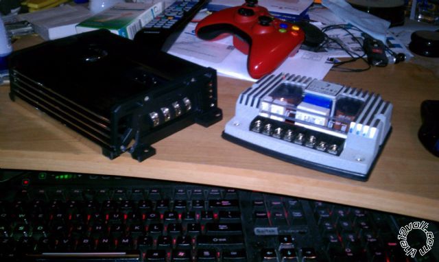

Posted By: soundnsecurity
Date Posted: March 03, 2013 at 11:09 PM
posted_image
this is the reason why i dont use my passive crossovers, the other crossover is a regular diamond HEX crossover and its pretty big by most standards, the HEX PRO is like a small amp.

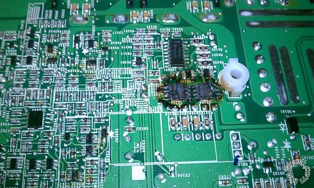

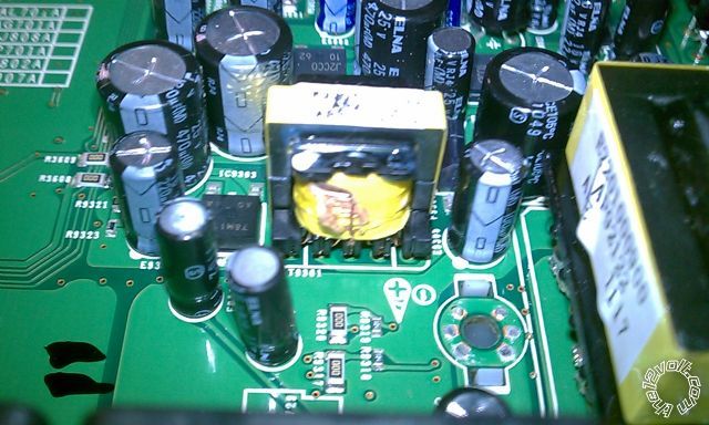

ok so i took apart my alpine and i want to know if this is fixable:
posted_image
posted_image
the board is burnt on the top and bottom in the same spot. i dont know what side started burning first but the bottom looks like it got the worst of it with those two chips being almost completely burned.
Posted By: haemphyst
Date Posted: March 05, 2013 at 7:32 AM
I hear IAAI furiously pouring through his manuals to find those schematics, even as I type this... posted_image

I say again, not using those crossovers because they are large is like not installing a subwoofer because it requires an enclosure. I highly recommend finding a way and I bet the system sounds better...
As far as repairing the amp, while I'm sure it is possible I'd answer the question "why did those ICs fry?" before I spent any time or money on it.
Date Posted: March 05, 2013 at 2:08 PM
yea ive already asked myself that question and i have no idea. i dont know enough to even begin to think about what these parts even do. they seem to be part of the power supply side of the amp but that is just a guess based on their location.
i guess ill have to consider finding a spot for the crossovers since they are bi-amp compatible i really wont have to rewire anything, ill just install them in between the speakers and amp and turn the filters on my active crossover off. i wont un-install it until im happy with the passives. i have to run new speaker wires anyway because i had to extend them when i replaced the amp and i dont like having them extended with lower quality wire than what i had.
