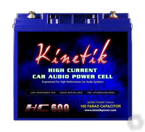

So if I had 2 of these, I would be good to go? I will be pushing 2360 watts max, and will not always be playing with the car off, but want the reserve power
posted_image
Or would 1 be sufficient?

The Kinetik Power Cell Calculator reckon you need an HC2400 (which is equivalent to SIX HC600s), not that I can find any info on how or what the calculator calculates (engine running; reserve time; high surge damage minimisation, etc).
My way: HC600 is 20AH; assume at C10 or C20 rate - ie, 2A for 10h or 1A for 20h.
Your load is 2360W ~2400W => 240A (a perfect application for the div-10 rule where the 2360W is output power).
Using a simple yet invalid calculation, 1A for 20h means 240A for 20x60mins/240A = 5 minutes. But it will be less than 5mins because the capacity of a battery decreases with increasing discharge current.
And since 240A is MUCH higher than its C10 rating of 2A, it wouldn't surprise me if it only lasted 1 minute or less instead of 5. (That's to its spec'd end voltage. I'd suspect the HC600 is a cranking type (ie, NOT deep cycle) and hence limited to a 20% discharge.
Adding the 2nd HC600 will double that reserve time. (Actually because of capacity-discharge-rate non-linearly, a bit more than double.)
In summary, using 2 HC600s on a 2360W output load will last a MAX of 10 minutes based solely on its C10 or C20 capacity. In practice they should last far less - maybe 2 minutes?
The HC600's discharge capacity curves are needed for accurate calcs.
As for dimming I can't say. Sometimes that has nothing to do with battery capacity and everything to do with wiring.
