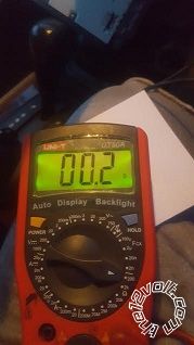

Posted By: red baron
Date Posted: August 29, 2016 at 2:46 PM
so this is how the metre is setposted_image
Date Posted: August 29, 2016 at 2:47 PM
the reading appear to be similar
posted_image
posted_image
