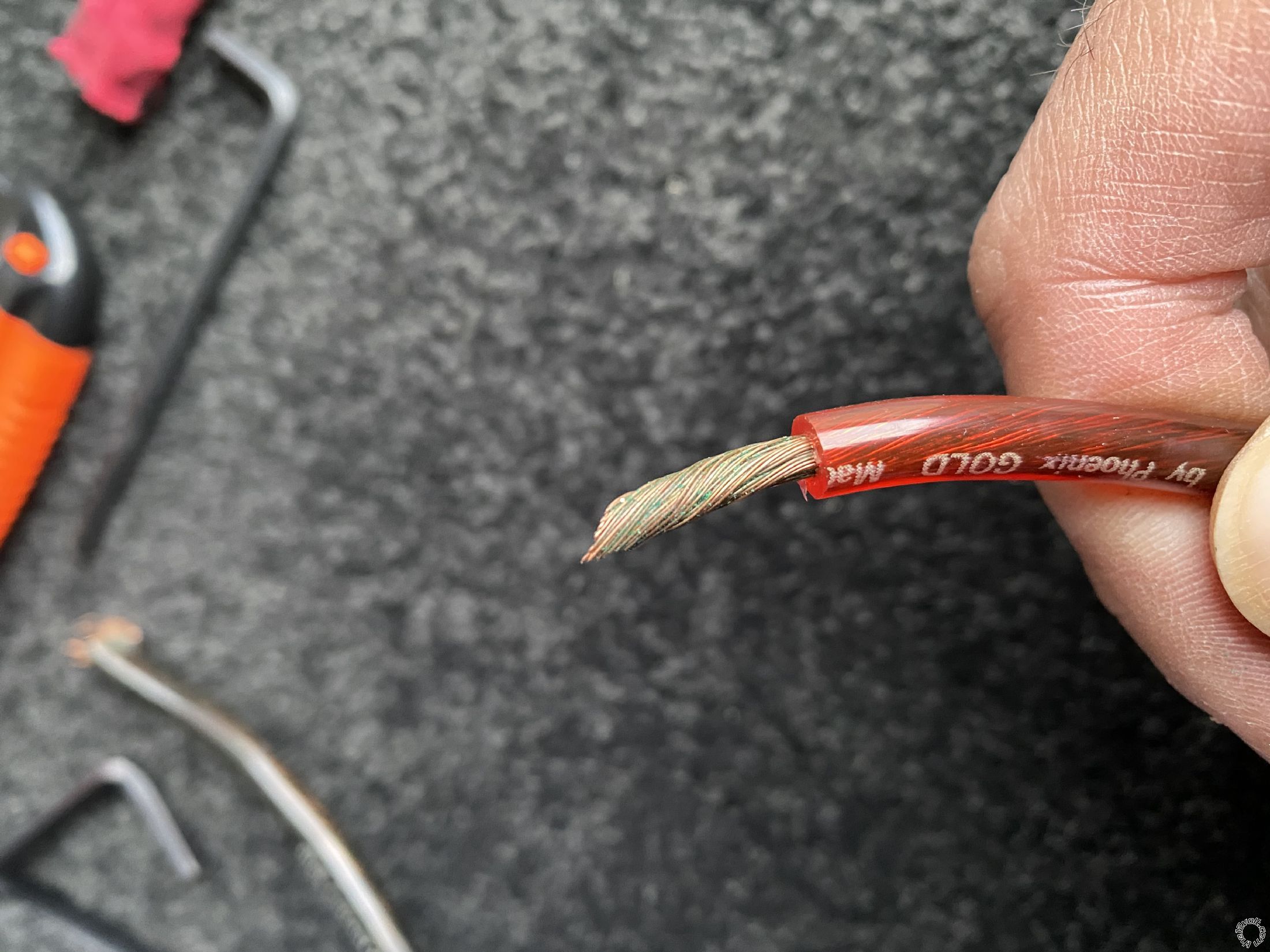

By the way, I also took the power wires out of the amp connectors since they were showing some corrosion. I decided to cut the ends, strip them back, and connect them again. I saw that both the ground and positive wires going into the amps are corroded. They are green around the outside perimeter of the wire. The center in pretty clean. The speaker wire appears to be similar from what i can see through the clear jacket but I haven't taken those apart and stripped them back. These are about 9 years old. I was thinking to replace all of the wiring perhaps and replaced the soldered "Y" connections to the amps with power distribution units while maintaining 4 gauge all over and eliminating the 8 gauge. See image attached of one of the positive 8 gauge wires going into the amp. Could this be causing a problem? The ground wire to the chassis looks good however. posted_image

Have you done the “big 3” upgrade or checked your factory grounds up front? You should have a fuse on the 1/0 gage power wire under the hood. From there the 1/0 connects to your capacitor, then splits off to your amplifiers? You should have a 4 ga power and ground wire running to each amp, preferably with a fuse block between the cap and amp.
