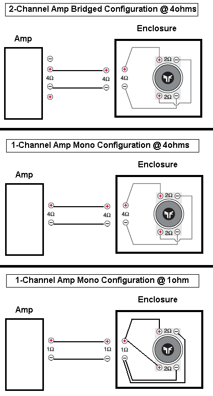

Here's the diagram I was telling you about. Sorry it took so long (I use Rockford Fosgate's Wiring Wizard for the basic portions, then manipulate the rest manually)
posted_image

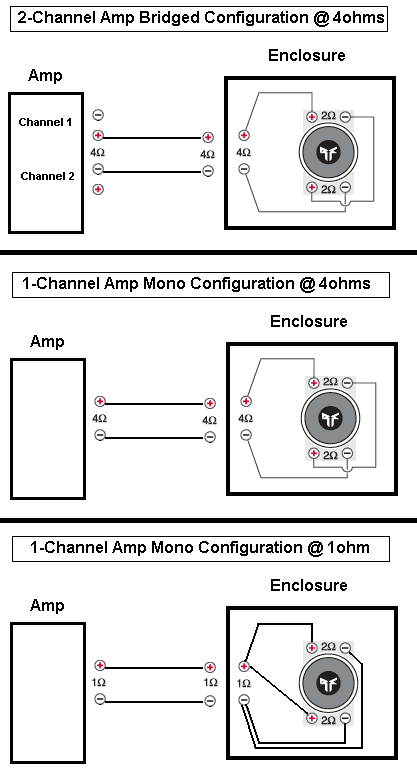

Posted By: wvsquirrel
Date Posted: September 04, 2003 at 5:29 AM
Forgot part of the first diagram, and I couldn't edit/delete my last post for some reason. Oh well, here it is again...
posted_image

Looks like you might be best off to get yourself a 2 channel amp and run it bridged in series for that sub. (refer to wvsquirrel's 2-channel amp bridged configuration @ 4ohms)
