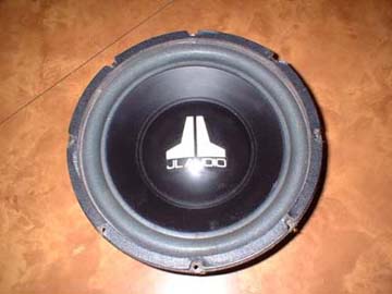

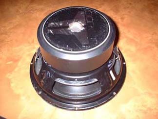

Posted By: Ishinc
Date Posted: October 02, 2003 at 9:58 PM
maybe you guys can recognize the sub....
Posted By: nedgeworth
Date Posted: October 02, 2003 at 10:12 PM
Think you might have to try that again.
Posted By: Ishinc
Date Posted: October 02, 2003 at 10:28 PM
okay let me try again...
Posted By: Ishinc
Date Posted: October 02, 2003 at 10:30 PM
well i guess pic upload doesn't work... but i emailed JL and i post when they reply thanks again!

okay guys, JL says it's the same as the 10W6ae so all of your suggestions are good! i can't seem to find many amps that is 1.5ohm stable....any ideas?

The JBL BP300.1 would be your best bet. It's your "best case scenerio" amp where the RMS of the sub equals the output of the amp at the proper ohm load. With the 300.1 you can get apx. 300 watts at 1 or 2 ohms (since 1.5 ohms is in the middle it will be the same as well), and your sub is rated 300 RMS at 1.5 ohms.
I would not recommend the 600.1 for 1 reason, according to JL the "Void Warrenty" zone for the 10W6AE starts at 500 watts. The 600.1 is apx. 600 watts at 1 or 2 ohms. You could try turning the gains WAY down, but you may still damage your sub by overpowering it.
It's ultimately your decision (and money!), but I would go with 300.1
Here's a link to JBL's Where To Buy page. This will show you "authorized" retailers.
If you want to go with "unauthorized" retailers, you can try eBay or other online stores. With these you will spend less (usually like half the MSRP), but will not get the JBL factory warrenty. ------------- Squirrel
