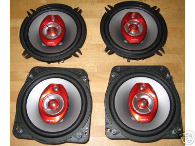

    the speakers in there now r sony explode 1's, the RMS is 25watts and the peak is 140watts

    sorry, they r:    5 inch diameter. Rated Power each 25W, PEAK Power each 140W lol and theres me thinkin they where 10inch posted_image
