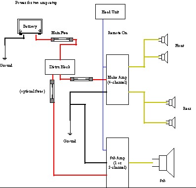

i want to learn how to hook up 2 amps
one for my sub woofers. and one for my 6x9 speakers.!

Posted By: DYohn
Date Posted: March 25, 2004 at 11:08 AM
I drew this up for you.  See if it makes sense.  There are other approaches, but this will give you the idea.
