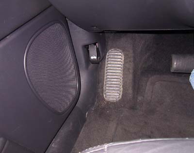

Here's my next problem.  I have big feet (size 13 shoe).  As you can see below my sebring doesn't leave much room for a decent sized kick.  I can't imagine fitting something anywhere close to a .5ft^3 kick in there.  This is why I was leaning towards a 4" midrange driver in the kick.  I could probably get by with very tiny enclosures and the response of the driver wouldn't be hurt badly.  Any thoughts / ideas?
