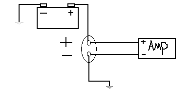

Date Posted: October 23, 2004 at 7:07 PM
I added a 4ga ground to my jetta. I think it helped a little, but didn't solve the problem.
Posted By: supradude
Date Posted: October 23, 2004 at 8:18 PM
you did the right thing by running the bigger wire for your ground. now you need to get a higher output alternator. i got mine from www.4alterstart.com and it solved my problems. and run your power wire straight to the battery with a fuse very close to the battery. this should solve your dimming light problem. i had no luck at all with stiffining caps.

i do have a 130amp alternator, so with the amp cranked (which it never really is), it would use 60amps.  So now i've got 70amps left to run my day lights, everything else is off. (well..  im sure theres a bit needed for computer and such, but thats minimal).  Even if I was left with half that, I would think that my headlights would be ok.
As for the cap (to keep within the topic of the forum), I found it made a big difference to the clarity of the bass produced.  I hooked up a volt meter before and after, and found it did even out the voltage spikes a lot.  Some things I have heard of that make caps not work so well include:
-Not grounding the cap seperatly from your amp
-Using too small a cap (0.5 farad cap will not help a 1000W system)

Posted By: tmallery
Date Posted: October 24, 2004 at 10:19 PM
Okay the directions for my cap are a little confusing. Does this image represent the proper way to hook up a cap to just one amp.posted_image
Posted By: Rushman
Date Posted: October 24, 2004 at 10:21 PM
you do not need a ground from the amp to the cap. Other than that it looks ok to me.
99 F-one fitty
Pioneer Premier H/U
Alpine EQ
Kicker 1200 amp
4 Kicker comp 10s
6 kicker SS65.2 components
Posted By: tmallery
Date Posted: October 24, 2004 at 10:24 PM
So then I just ground the amp seperatly.
Posted By: Rushman
Date Posted: October 24, 2004 at 10:29 PM
yes that should work just fine. Altho Im thinking theoreticly the amp and cap could be grounded together and share the same wire but Ive never seen that done so I would just go ahead and ground them seperately.

Posted By: stevdart
Date Posted: October 24, 2004 at 10:30 PM
Yes, cap to ground...amp to ground.  You can use the same chassis grounding location for both ground wires.
