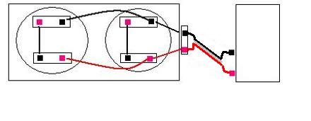

    Yes, that's what it is.  These diagrams are shown like that to make everything neat and tidy, and all the lines will be straight.  In real life it would look more like the following, one that I drew:
    posted_image
    The wiring is series/parallel, in that the coils of each sub are in series and the subs themselves are in parallel (as in option 2 in the above linked diagram).  Connection to the amp is normally shown without detail, because in some cases:
