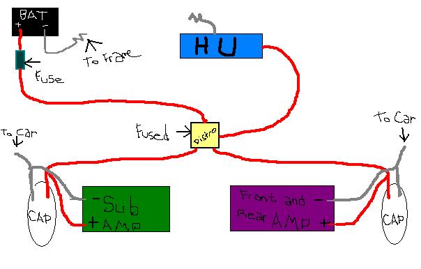

Here is a Picture of My current power setup.
Please let me know your professional opinions.
posted_image
Posted By: kfr01
Date Posted: February 21, 2005 at 1:36 PM
My comments:  get rid of the caps and ground the amps to the same point.

Date Posted: February 21, 2005 at 2:28 PM
The reason I got the CAPS is because I had problems with my Battery kept draining (This system has been through 2 other batteries not including the one I'm using now). It seemed like I had to replace the Battery every year. Ever since I got this system built with the CAPS, I haven't had any problems (no dimming Headlights even when the bass hits). Had this new DieHard Gold Battery since 2003.
I got the CAPS as a suggestion from someone to solve some of my power problems.
If I remove the CAPS, will I run into probs again?

Posted By: DYohn
Date Posted: February 21, 2005 at 2:56 PM
What's the car?  Sounds like your alternator may have tested OK, but it simply does not have enough capacity.  Upgrade your alternator.
