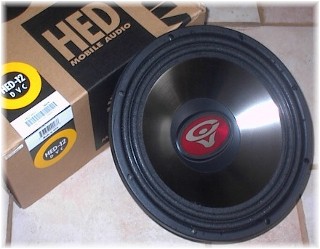

https://www.thezeb.com/p-Cerwin-Vega-HED-S1000-10-inch-Subwoofer-108610.htm  As usual, when you're looking for something from one of these online guys, they get the words wrong....This is the SVC 4 ohm sub and the CV site rates it at 300 watts RMS.  So you see two extremes here and both are actually probably wrong.  I believe the true RMS rating for each sub is 250 watts.  I wouldn't power one up with any more watts than 250, but like I said I ran one for awhile on 75 watts.  And IIRC it (and the SVC version that followed) came from theZeb.
This is what they looked like a year ago:
posted_image
(...looks like they're putting some kind of fancy-looking cover over the magnet now...gotta have that Audiobahn look!...)

Poorman, you should read everything I say before you go blowing it out your ass.  I'm not even going to bother explaining things to you except that you should click on the link that I was referring to...
...that pic happens to be one of  my CV HEDs....duhhh!
