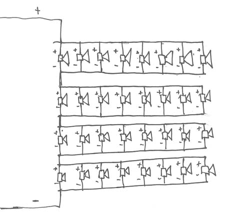

Posted By: stevdart
Date Posted: March 24, 2005 at 9:43 PM
How many tweets do I need for my amp (SPL question)?
You need this many like this:
posted_image
Dude, that's what I needed to know.  Thanks!
..........uh...uh...but Dude, wont that hert my ears?
It's SPL, who cares?
okey, thanks.
............but,  uh....it wont pressurize the cabin!
Good!  There's a benefit I didn't think of.  Now you won't need your SCuBA gear!
