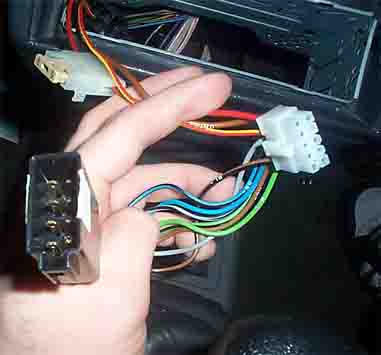

I am a complete noob when it comes to car audio, i am trying to simply instal a stereo to my car, i have removed my radio cassette player. im looking at the wires and connections from my cars power supply and im looking at the new stereo wires and im thinking sh*t there not the same connections and the wires are different colors. so...
i have a Renault clio the stereo is a SONY CDX s2200
so far i have worked out that there is a ground wire, 12v constant and 12v switched and speaker wire from the stereo. the other wires are not of concern... i think >_< (im not thinking about the amp, sub ect)
from my car there is also the same wires, but they are different colors and have a different connecter. i thought ok what if i cut the car power wires and join them to the stereo wires that makes sense! but i feel like i might be doing something wrong. any advice about how to wire the power from my car to the stereo? i dont want to blow the fuses or get electricuted thanks
i have a feeling this question cant be asnwered that easily without seeing my equiptment, but its worth a try

Buy a multi-meter! or test lamp. one of those spare wires is ILLUMINATION / not needed. but dims screen when lights are on.
how olds the car? have the wires in the car been chopped B4? what area do you live in?
Dude,...If the wiring from the car is standard it would have plugged straight in? I hate it when someones been in there & cut everything, REACH FURTHER IN IS THERE MORE CONNECTORS?
Renaults have ISO connectors, top plug is for the 4 speakers, 8 pins l/r-.l/f-.r/f-.r/r-. &++++under!
then theres the same 8 pins on the 2nd connector s/p. n/a. e/a. +15. under: t/m. +30. ill. neg.
the clips are staggered so you can't plug in the wrong connector. Every stereo you buy here has ISO's.

hi
the car is a 96, can you see in the photo if that is an ISO conecter? im not sure about it. the black plug looks like the right kind of connection for the stereo but the power wires are going into that white connecter and the speaker wires are on the other plug i really dont know, so im hoping you can tell me something form the photo
thanks for your help, appeciate it

i just want to point out that there are speaker wires further down under the cage, but no other wiring i checked
Posted By: luan
Date Posted: April 21, 2005 at 1:13 PM
ok i feel like an idiot now, the wires you see in the picture are for the previous tape/radio i had taken out. i unplugged them and realised there was an iso connection >_<
i plugged the stereo right in, how stupid that i didn't notice that. i guess no one replied becuase it was too basic of a task. thanks for letting me figure it out myself.
