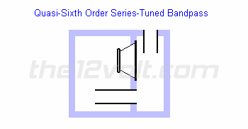

I just looked inside the port of the Alpine compound reflex box. It's weird... It has slot port that goes the depth of the enclosure (it's on the left side of the box) and then two circular ports connect the slot port to the main part of the box (where the actual subwoofer is). Does anyone know what this design would be called? Here is a drawing:
It looks similar to this sixth order box, except the woofer is mounted on front instead of inside the box.
Posted By: Alpine Guy
Date Posted: April 23, 2005 at 10:48 PM
Compound Reflex
------------- 2003 Chevy Avalanche,Eclipse CD7000,Morel Elate 5,Adire Extremis,Alpine PDX-4.150, 15" TC-3000, 2 Alpine PDX-1.1000, 470Amp HO Alt.
