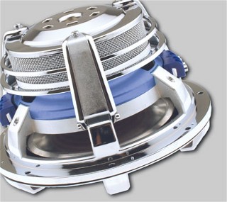

If you have a great driver and a well-built, properly sized enclosure, then loss of SQ should not be a concern.  There are some tight situations where the only way to build the sub is to invert it because of space limitations...in SQ systems.  IIRC S. Kephart has something like that in the front of his car, and he's all about SQ as you all know.  And if using enough power, loss of db's wouldn't be an issue either.  I've not heard of any complaints where someone inverted two of three (or so) subs, had the air volume corrected to compensate...and noticed a reduction if db's after doing so.
I'm of the opinion, however, that in most cases of sub inversion, the purpose is to show off the rear end of the driver.  That's not SQ talking.
