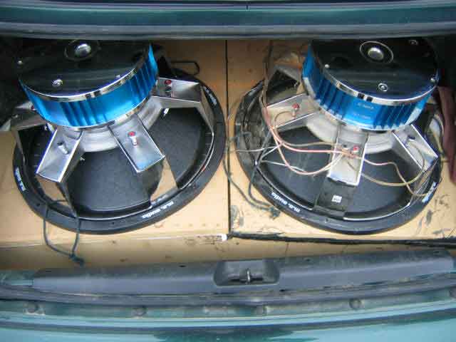

posted_image
get some ma audio subs and amps...they pound hard....i got 18's in my civic..get some nice 12d06's..and a nice ma high current amp.

yikes bro.... that has to be one of the sloppiest looking installs i've seen in quite a while.......

Presentation, freeworld, presentation.  You should lock up that trunk.  Chain and padlock it for good measure.  This is an installation where you should let the beholder use his imagination.
