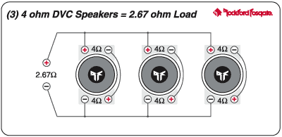

Alpine type Rs? Almost 6 in" deep. Go back to square one. JL's 10" W1V2 are by far the best sounding " shallow  mount ", " small enclosure " sub out there. Use three 8 ohm tens for a 2.7 ohm load. I've done this to your truck and it sounds great.

How would you wire that to get the 2.7ohm load?
