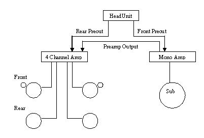

This just brought up another speed bump/question. My head unit only has two preouts, front & rear. Once I add the sub & amp, how am I going to get the input for it? The JL 250/1 does have a preout on it for the next amp. My Alpine head unit says I can change the settings to leave the front preouts unaffected by the fader, so would I run the front preout rca to the sub amp, then from the sub amp preout to the front channel input on the 4 channel amp? And run the rear channel preout from the HU directly to the rear channel on the 4 channel. Sounds right to me, but need advice (as always). I don’t want to upgrade the HU at this point, I’m working up to a flip-out DVD multimedia player, so don’t want to cough up money for a new HU just yet.
I think I almost got it. Maybe.

Use the preout that is meant for the sub to the sub amp, the other full-range preout to the 4 channel amp.  Use splitters on that one to feed the extra two channels.  Your head unit will have a control for sub out, I believe, IIRC, and one of the preouts will be designated for sub use.

The back of my head unit (Alpine CDA-D852) only has PreOut Front & PreOut Rear. No Sub Preout. Per the Alpine Manual it allows the following setting:
Non Fading Pre-Out (N.F.P.)
 - NFP On - In this position, the front Pre-Out will not be affected by the fader.This is ideal for driving a subwoofer
   amplifier.
So what would be the best choice for hookup?
1. Front Pre-Out With "NFP On" To The Sub Amp, Then From The Sub Amp Preout To Front Input On 4 Channel
2. Front Pre-Out To 4 Channel, Y'd Out To Front & Rear, Rear Pre-Out To Sub Amp
As I mentioned, I don't want to purchase a new HU just yet, waiting to save alittle more and get an in-dash DVD. The flip-out I'm looking at does have 3 Pre-Outs (Alpine IVA-D310). Wife would not be happy to spend another $1300 at this point!

I like option #2 for more flexibility - you're more likely to adjust sub volume on the fly than you are the front to rear fader.  It's all temporary til the new HU comes in anyhow.
That brings up another question - does your main amp have an x-over, or is it running full range?  If it has an x-over, I'd DEFINITELY use that, I like 80-90hz, but it depends on your ears & how the individual speakers do.
The other thought I had was the box size.  .6 cu ft for a 10" ain't huge, and it means it won't be super efficient.  It's certainly within parameters & will sound very tight, but generally a smaller box requires a bit more power than a larger box to get the same sound from (let's see who attacks that statement).  It'll really depend on how efficient the sub is & how much bass you want.  Check it out early, if it feels like you need more power, take the amp back & trade for a larger one.  Most shops are good about that if the amp is still new.  I still believe the 250/1 is a good place to start.
Good luck.
