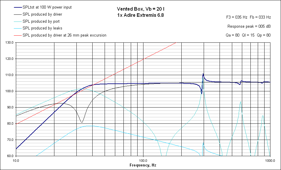

Correct me if I'm wrong here.  I modeled a few different sizes keeping the tuning around 33-35 and they seem like they'd be great for what I want them for.  They were all pretty flat after 70hz from 10-21L and the above tuning.  As far as 21L @ 33hz, I was just going with what the link said even though it was for a large room.  Thanks for your help.

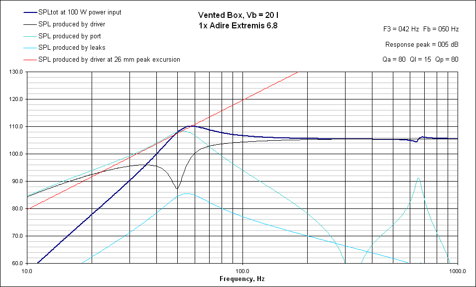

That driver looks real good tuned to 33 Hz with 21 liters until you start looking at the port diameter vs. the power input.  It needs a 3" diameter to handle 75 watts and up, but it causes a severe port resonance peak at ~300 Hz, which is going to be in it's range.  Reducing the port diameter to 2" eliminates that port resonance but the program warns of port noise at that size.  (Be sure to check the box that says "include effects of port resonance".)
A compromise would be to tune the enclosure higher, resulting in a much shorter port length... to around 50 Hz   The crossover would have to be a steep one to cross this over with the sub at 60 - 80 Hz.  Looks a bit touchy.  And in neither scenario will the port actually function for (primary) sound, because the tuning frequency will be crossed into the sub's territory.

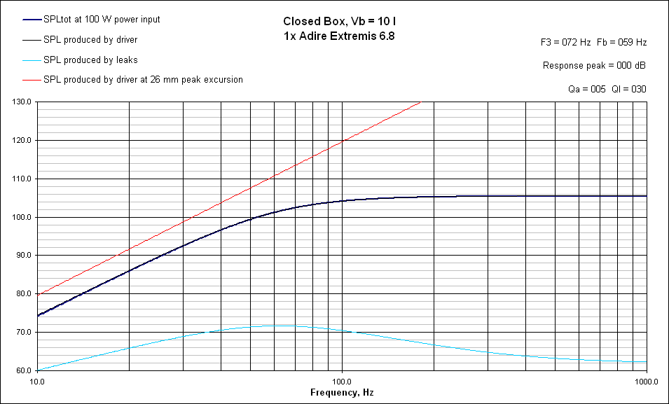

Then you look at the sealed enclosure graph and it starts to look quite good for your application!  Looks like a nice crossover to the sub using an 18 db/octave slope on the crossover and no worries about ports and port resonance.  And....a much, much smaller enclosure, as I thought the vented boxes didn't look good under 19 liters.

Yeah, unfortuanately for me I have no one within 200 miles that sells them so I can't hear them.  I thought I'd use the 21L @33hz because if you look at the top of the page I linked earlier it says "our favorite" for that configuration.  Again though, thats for in home environment.  I'm sure sealed will be good.  That 10L sealed I think is what DYohn used when he listened to them.  He said his kicks were .3 ft3 if I'm not mistaken, and he liked them from what I gathered.

Look again at the graph for 21L, 33Hz.  You see that nasty port resonance?  At 300 Hz that's within the vital range of that driver, and it's a 10 db jump.  I would avoid that.
