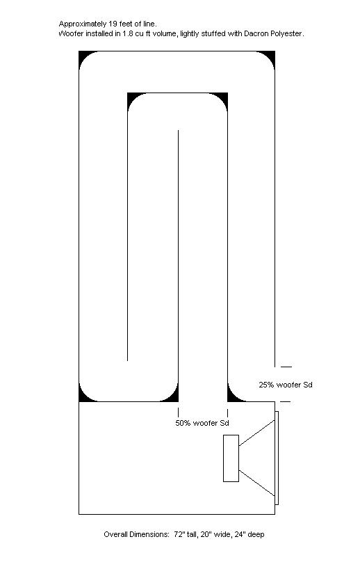

Thanks for the compliment. Their construction was QUITE involved, and the payoffs are certainly worth the efforts expended. I'll draw a quick diagram of the internals, and post it soon. The numbers I post MAY not be exact, but I'll try to remember them as best I can.
Posted By: haemphyst
Date Posted: November 29, 2005 at 5:40 PM
posted_image
There's a pic of the internal workings. Keep in mind this is the second one - the "New, Improved" version. The first of the pair, was larger, had slightly more line in it, and was actually tuned lower. We did discover that, while we were aiming for an Fs of around 16 to 18Hz, our Fs was consderably lower than we were actually aiming for. This we attributed to the friction in such a long line. I might also add that hitting an Fs LOWER than desired is not always a bad thing... posted_image
The first enclosure also did not have the rounded internal corners, and it is possible to hear this fact. At the lowest frequencies, and at REALLY high levels, you can hear the air turbulence in the line. This happens as the air moves around square corners. For normal listening levels, though, it is a not issue.
