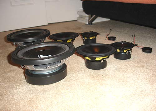

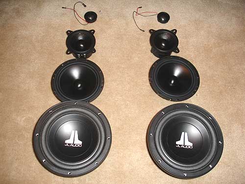

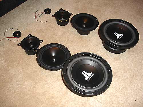

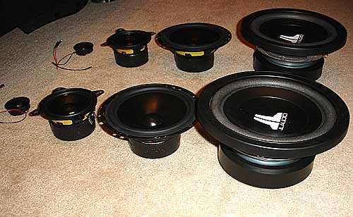

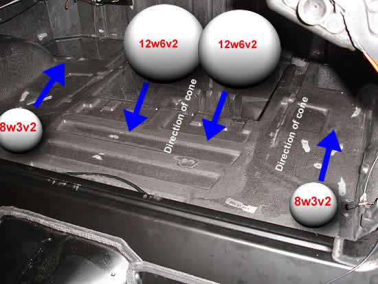

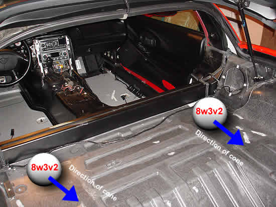

I have taken the time to provide you with some pics of the progress so far, enjoy:
We are currently awaiting the arrival of our 3rd 50 sq. ft. roll of sound deadener. This will be enough to finish the trunk area, and provide a 2nd layer on parts of the passenger's side location, just like the driver's side is covered.
This should give you a better idea of the space that we have to work with. Very limited, but very possible.
-Alex

Could you please post a pic of the other side of the stock bose subwoofers? I'm curious what they look like.

Why not make a custom enclosure for the 8's and put them in the space between the driver and passenger seats?
Something like this...

Date Posted: December 23, 2005 at 10:08 PM
It's interesting that you mentioned the new idea. I have looked over the entire car with my co-installer, and we've decided to put the 8" absolutely NOWHERE near the front of the car. We're actually going to put them at the corners of the trunk (about 1 foot behind the back of the seats). Take a look at the layout pics:
posted_image
posted_image
Posted By: luckydevil
Date Posted: December 23, 2005 at 11:13 PM
Won't they just cancel eachother out that way?
Posted By: blazinls1
Date Posted: December 23, 2005 at 11:17 PM
Yeah it does seem that way, doesn't it? The ONLY reason that won't be cancelling each other out is because they will be connected to an Active Crossover; their frequencies are split up so that the 8" and the 12" are playing different frequencies (no cancellation).
Date Posted: December 23, 2005 at 11:24 PM
Okay that makes sense, but aren't they designed to play the same frequencies?
Date Posted: December 23, 2005 at 11:35 PM
Right now, we have decided that we'll have only the JL Audio 3-way set (2" tweeter, 4" midrange, 6.5") custom molded into the doors of the 'vette. I actually just received the set today, check it out:
posted_image
posted_image
posted_image
posted_image
Date Posted: December 23, 2005 at 11:46 PM
luckydevil: Well, let's put it this way... you were to let a 12" subwoofer the full range of frequencies, you will hear something that you'd want to shut-off within seconds. The vocals and midrange of whatever you're listening to would sound VERY muffled. This is mainly because each type of speaker has it's specific purpose. That is why the tweeters obviously cannot play any bass.
So how does this relate to what you asked? Well, the 8" are designed to be able to play up to a higher frequency than the 12", generally. The 12" subwoofers can hit MUCH lower than any 8" subs can hit. That is just the nature of the drivers. Not to mention that both of the 8" subs and 12" subs in our system will be connected to an active crossover. Thus, the crossover will almost COMPLETELY slipt up the frequencies so that the 8" subs will NEVER play the same frequency as the 12" subs are playing. For example: the 8" subs will be set to play 200Hz down to 50Hz, and the 12" subs will be set to play 50Hz and everything down.
I may have not been 100% accurate in my explanation, however, this is basically what I have learned about this topic so far.
