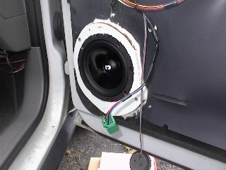

The MDF baffle:  measure to see what space you have.  You can use regular 3/4" or you can use plywood that is 5/8".  You could also rout out the perimeter of the mounting hole so that the woofer sits flush with the surface if front room is too close.  Cut the baffle size so that it fits the door, no matter what shape that would be.  Apply caulk to the back where it contacts the door panel and then screw it in place.  Caulk all around it once it's installed.
posted_image
The mounting baffle in this pic was once the top of a put-it-together shelf unit, which is why the surface is painted white.  I flush-mounted the woofer by using a router.  It is screwd into the panel with sheet metal screws and caulked.  I doesn't matter what the shape of the baffle is as long as it fits the confines of the door's contours.
