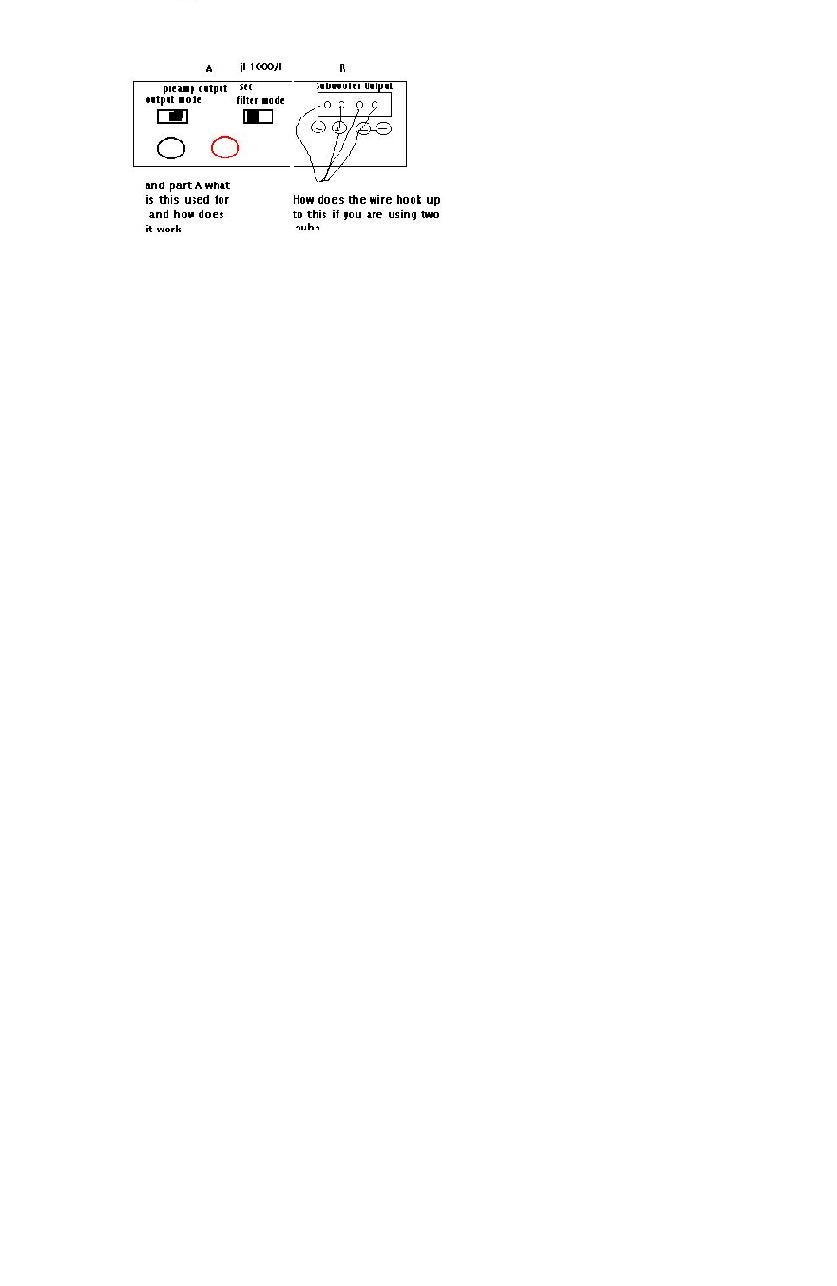

ok what i need to know now is what is the Preamp Output Sec. and the amp input sec. and the Subwoofer out put sec do. And what settings shoud they be on posted_image

Posted By: brans_88_stang
Date Posted: January 27, 2006 at 3:06 PM
posted_image
Brantheman
Posted By: geepherder
Date Posted: January 27, 2006 at 8:04 PM
The preamp outputs will not be used unless you're sending a signal to another amp.  Infrasonic is JL's fancy lingo for subsonic filter, which you will not need if you're using a sealed box.  I recommend starting with the bass boost off.  If after you set it up, you feel you'd like to use it, read your manual and it will explain the different adjustments.  For the low pass, start around 80 Hz and work from there.  Set the slope to 24 dB initially, then switch it to see which you prefer.  Depending on how strong or weak a signal your amp is getting will determine whether you set the input voltage switch to low or high.  Your manual will give the specifics as I don't remember the exact numbers.  Input sensitivity is gain- you can do a search in here on gain setting.  Output polarity will switch the input signal 180 degrees- unless you have phasing problems, this will be left on normal.

the amp has a preamp output, amplifer input. and a subwoofer output with 4 holes two pos and two neg what plugs into all this three things
Date Posted: January 28, 2006 at 3:12 AM
posted_image
Brantheman
Date Posted: January 28, 2006 at 8:03 AM
Why do you insist on using the preouts on the amp?  How many sets of preouts does your deck have?  If you have front/rear/sub, then you'll use the front/rear outputs for your interior speakers' amp and the sub outputs for the sub amp.  If your deck only has front/rear preouts, you can use one or the other (preferably fronts) to connect to the sub amp, then you'll set the preamp outputs on the sub amp to full range and use the crossovers built into the next amp.  If your deck has a sub output and you use that, do not use the preouts on the sub amp because you might send only bass to the next amp.
As far as the speaker outputs go, it doesn't really matter as long as you don't connect too low an impedence (below 1.5 ohms I believe) to the amp.  It's a mono amp, so both the positives are the same, and both the negatives are the same.  You can just run one positive and one negative to each sub.
