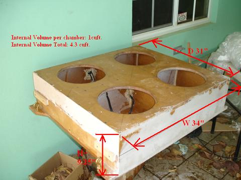

why you don't go with 4 12"? 4 12" single voice coil(4ohm) is better for the ohm load(1 ohm) and better spl than 3 12". also how are the subs going to be, upfiring? if so, build a box with these dimension: W34" x H9.25" x D31" 3/4" thickness that's 4.2 cuft tot. and 1cuft per subs, put a divider for them so each subs get it's own chamber (1cuft). that will be more than enought for those kappa's and be pretty loud also. i have the same box dimensions in a toyota corolla with 4 12" subs and it fit nicely, you have a 2005 chevrolet malibu, so space is not a problem. and what's the rms of the pyle amp? if i was you check a better amp. pyle is overated.

4 12" sub will fit in a sealed box with dimensions w34" x h9.25" x d31" and 3/4" thickness.

hey Aruman I'm confusedposted_image because if side by side 12x3=36" wide and @9.25"h how can a 12 fit inside a 9.25"h tha depth I can get

it will fit, but not like 3 12" side by side like you said.
also the subwoofers that you plan to buy the infinity kappa wich one? the infenity kappa series(350wrms) or the kappa perfect(400wrms)? because both of them will fit, the kappa series have a depth of 5" and the kappa perfect have a depth of 7". I have 4 12" mtx 7500 and they have a depth of 7.198" and they fit nicely in the box and the box fit nicely in my small trunk car. here is a pic of the box that i made.
posted_image
