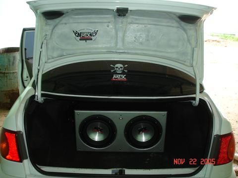

hi guys, yesterday i install 4x mtx thunder 7500 12" in my corolla i have them in sealbox with 0.81 cubic feet for each subs, it sound very hard, but i lost the low freguency they told me that's because that the box is to small for them, they needed 1.25 cubic feet to work fine, but i cannot make a box that big, i can make one that is 1 cubic feet, so my question is should it be a hearing difference if i gave my 4x 7512-04 subs 1cubic feet per subs, that what i have right now(0.81 cubic feet) for them? thus should it be a huge difference between 0.81 and 1 cubic feet? and is it normal that the cones of the woofers get warm? anyways, thanks guys.

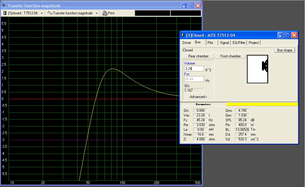

I looked at these subs using  WinISD.  The MTX website is good about disclosing full parameters so I loaded it up and gave it a look.  Here's the response with the 0.81 ft^3 per sub you now have:   t7512-04at0.81x4.jpg
Compare that to this response with 1.25 ft^3 per sub:  t7512-04at1.25x4.jpg
You see that there is less of a peak in the response but the low end is still not there.  That's just the way this sub works, from what I can tell.  Take your time and set this system up so that the amp is not overworked (if that's a problem) and that the amp's gains are set right with the deck output (so that there is no clipped signal).  After the very precise setup is done, you can open up that enclosure and stuff it with polyfil to bring that peak in the response down a bit.  Other than that, the box size as you have it is fine.

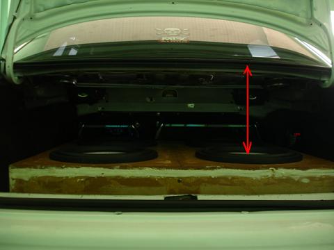

Hi guys thanks for answer me. yep my problem is that i lost the low frequency that i had when i had 2 Mtx 9510-44 sealbox, when i had the 9500 series it was very loud and low i played songs like: late nite tip, little john and it sounded very good compared now with my 4 mtx 7512-04, now it punch very hard, but no low freq. or that's because of the aiming of the subs? So i will make a new box and gave them 1 cubic feet each. If i make my box larger would i get more spl than with what i have now(0.81)? or if i make it larger i'll only get the low freq.? i'm using the MTX TA81001 that's rated 1500WRms @ 1 ohm, but mine can give me 1958Wrms at 1 ohm, so i think power is not the problem, right? i read that those mtx 7500 can take more than they rated 400watt rms. but i don't know if it's true. another quest. is it ok that the magnet of the subs is flush mounted with the wood of the box? or should it have a space between? i know a guy that have 4 of those mtx thunder 7512-04 in 1.25 cubic feet(seal) per each subs powered by 2 mtx thunder 801d in a Mitsubishi Eclipse, and that thing was freaking loud and also low. but i cannot gave mine 1.25 because i have a Toyota Corolla thus no big trunk space, so mine will not be loud as the Eclipse(hatcback) but can't i be at least closer? anyways guys, thanks very much and i post some picture of what i had before(2x mtx 9510-44) and what i have now(4x mtx 7512-04).
posted_image
posted_image
posted_image

Aruman, look at the data Stevdart was kind enough to provide.  You will never get much more out of these subs.  The difference in Fc between the enclosure size you have now and 1.2 cubes is the difference between 65 and 53 Hz.  These subs are designed mainly for SPL competition, not for deep bass.
Larger enclosures will get you a little more deep bass extension, but these guys cannot hack below 40Hz (look at that fs!) unless, maybe, you remove two of them, keep the same enclosure arrangement but open it up so that each sub can use 1.6 cuft (which is still too small by the way) and port them for 38Hz, which will help reinforce that low end.

Aruman, in my shop, we have done those false floors' with four 12's on several occasions. Some times (such as in a previous gerneration Mustang) they simply make earthquakes, but other times (like when we put that same setup into a Civic sedan), the results were a bit dissapointing.
Also, remember that an Eclipse is a hatchback coupe. Like the old Honda CRX's, hatchbacks are some of the easiest cars to make pound very hard. There is no trunk, so bass response is directed straight into the cabin. It would be difficult for a four door Toyota Corolla to match that kind of immediate response, especially with the amount of sound deadening being placed into the modern Toyota.
The same individual who had the Civic sedan had us take out the four 12's and put three of them into a rear-fire box. The verdict? MUCh better SPL. The three 12's firing toward the rear severly out-pounded the four 12's up-firing. With the limited trunk space available to him in the Civic, placing them to face the rear allowed them to have much more trunk space to play with.
We've seen the same phenomonen with two 12's...firing them back seems to yeild much better bass than aiming them up.
If it isn't too much trouble for you, I would say take them out of that box and put three of them, or even all four if you can find a way to make it fit, into a rear fire box placed roughly in the middle of your trunk. I'll bet that the results please you.

I kinda get the impression you aren't sure of what to look at when you're faced with a response graph like the two I linked to.  You still seem to be inclined toward rebuilding the enclosure for more space and re-aiming the subs.  At the same time you're saying you want deeper, lower bass.  But whether you know at a glance what those graphs tell you or whether you don't have a clue, I'll go over some telling points briefly here...
Open up the https://www.the12volt.com/installbay/uploads/t7512-04at1.25x4.jpg, which shows the response of THESE subs in a box with 1.25 cu. ft per sub...a total of 5 cu ft.  Look at these 'tells' that will tell you without a doubt that you will not be enjoying deep bass from these subs no matter how big the box is:
(use the 'expand' icon in the bottom right of the screen to clarify the image)
  • Parameters from the manufacturer's data:  look at the Fs, which is 45 Hz.  That is the resonant frequency of this sub and it doesn't play anything lower than that freq.
  • Qts = 0.846  A high Q that tells you that this sub will work the best for its design in a sealed box.  Venting is an option, but the gain is minimal at best.  Better gain is had just with the car's natural frequency (cabin gain), which is a freq range in line with what this driver does best - SPL.
  • The chart:  look at the left column which reads in decibels.  The -3 point is F3, which is considered the lowest frequency this sub can play because it is at half power at that point.  You see that it is at 45 Hz, and this is with the 1.25 cu ft per sub you're aiming for.
  • The distinct hump, or peak, in this response shows the range of frequencies that this sub is designed to deliver (frequencies are shown along the bottom of the graph).  L'il John likes it a bit lower than this.  You can see that this sub delivers in the range of 50 Hz up to the crossover point.
Instead of spending more time and money reconfiguring the enclosure, you should switch to a subwoofer that will provide the bass response for the type of listening and type of music that you like.  Look for parameters with a lower Fs in the 20s or 30s and a Qts between .3 to .5.  You'll find that a lot of subs will fit this category.  Go a step further and narrow it down to subs that like a .8 cu ft sealed enclosure and also have a long throw like these do, and you can keep the upfiring box as you have it.

You know, it would be nice if we could just look at a couple of parameters in a sub's spec sheet and tell how it will perform, but that's just about impossible without putting it in a box modeling program like WinISD and looking at it.  One of the best things to do is exactly what you are doing:  talking with friends who have used some different setups and personally listening to the results.  Nothing tells more than true-life results.
On the subject, though, of Fs and how it relates to how deep the bass response can go:  you can't always tell by the Fs of the driver just by looking at the number.  I picked another sub at random just to see what it looks like modeled in the program.  The Memphis M-class MC124, a single 4 ohm sub similar to what you have.
https://www.memphiscaraudio.com/products/details.asp?cat=&id=50&p=2 and https://memphiscaraudio.com/LiveImages/114/7/DocumentURL.pdf for the parameters.
You see that this sub has a low Fs of 28 Hz...but look at the response in the link here:
memphismc124-mtx7512.jpg  Open up the response I gave you in the last post to compare.
All three of these use the same 5 cu ft box for four subs.  The colored lines you're looking at are this:  yellow is the Memphis in sealed.  You see that even though it has a much lower Fs, it still gives a response very similar to what you now have with those MTX 7500s.  F3 is at about 45 Hz.  The SQ is better, though, because there is no 'hump' in the response.
The green line is the same box size but vented, and using the Memphis sub.  There is more SPL and low end extension because of the vented box that is tuned to 30 Hz.  The difference that you see in this graph between the yellow and green lines doesn't look like very much, but it is a big difference in output if you want deep bass in the popular music we listen to now.  The F3 hits lower at 39 - 40 Hz and makes a huge improvement in those deep bass hits.  (This is my way of answering your question above about comparing this sub to your 9500's).
The third line, the blue one, is your MTX 7500 in the same 1.25 per sub box but vented.  It is tuned to 40 Hz.  You see that this extends the low bass output...the F3 is at 32 Hz.  But there's a big price to pay for this low end extension.  Look at the huge peak in response that happens when you port this particular sub:  you get a peaked response of over +5 db.  What that means is that even though this sub/box combination will perform to lower bass, the benefit is outweighed by the increase in db's at the higher sub freqs.  You would have to adjust volume because of that peaked response, which would further make that F3 point seem more like a F8 point...8 decibels lower than the majority of sound that you're getting.
