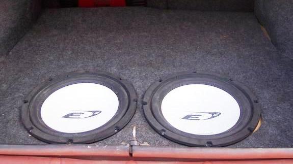

Posted By: badtazboy
Date Posted: April 13, 2006 at 4:18 PM
saturnsubohio:
found someone on cardomain who had done what I am looking but I want mine to drop lower (want to hide them under the carpet, going for a no show install). Looks like it’s just a basic build. I guess my question should have been initially:
Does anyone know of a good pair of shallow mount subs?
I am not opposed to doing 10’s.
Here’s picks off cardomain:
posted_image
posted_image
posted_image

Posted By: bandarenko2003
Date Posted: April 13, 2006 at 7:51 PM

You're going about this the wrong way.  Once you choose a sub you like, decide what kind of enclosure to use (based on what's recommended for it, and your liking).  Then either build one (have one built) or buy a prefab to fit the bill, and select an amplifier.  Do some searches in here (upper right of the screen) and read up- you'll find lots of useful links and info.  Q-logic makes several kinds of boxes of all different types/sizes, and yes, they are already "tuned".

Posted By: jazzcustom131
Date Posted: April 13, 2006 at 9:26 PM
I would like to point something out.
You say you need all the trucnk space you can get. That tells me you're going to be putting things in the trunk.
That would require you putting things on top of the subs. They generally do not appreciate being held down, where they cannot function properly. You may need to consider some sort of protective device for tops of your subs. The half-a aluminum grate style covers from wal-mart are not an acceptable answer either (you know, the one's that cost 5 bucks)
saturn(what ever goes here) has a good idea. the side wells may not be a bad idea.

Posted By: saturnsubohio
Date Posted: April 27, 2006 at 11:00 AM
bass = omnidirectional.. so the "sound" you hear would be equivalent.
it will come down to how you build the box and how you prepare your trunk.. i myself suggest taking off the reflector and tailights and getting some deadening materials in there.
