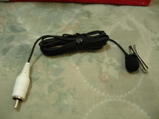

Posted By: Aruman
Date Posted: May 17, 2006 at 10:31 AM
Here's the mic of my CD8455

Posted By: killer sonata
Date Posted: May 17, 2006 at 4:09 PM
Well my MEI100 just came in the mail and ofcourse I tried it out right away. Im kind of at a dissadvantage right now though because all of the speakers on the passenger side are disconnected because Im making custom door panels. I tried it out anyways and it already made a huge difference.Aruman, my mic looks just like the one you have pictured there. I strongly recommend anyone with the 8445 or 8455 get one if you dont already. I was ready to sell mine and go back to my 8443 because of its better tuning capabilities but the mic fixed most of it. Anyone want to buy my 8443?
