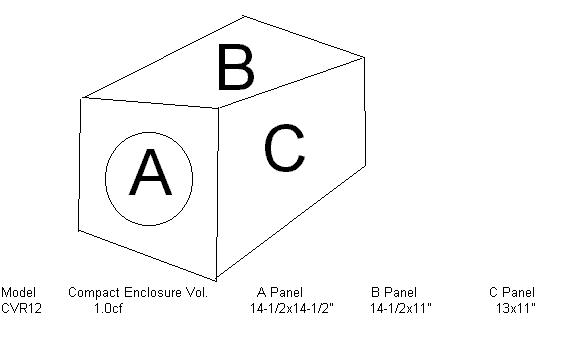

Stevedart: I'll be using 2 12's, the '04 model I think. Before they made the ugly chrome ones.
The specs in the booklet that came with the subs say...
posted_image
There's a crappy drawing of what it shows in my booklet. I'm just curious if the 17" depth box will sound better than my current 12"depth box. Or if I need something with even bigger depth.

Very little difference to be heard if any at all.  The new box size is barely more than the old one in the realm of the leeway in box sizing that KIcker recommends.  You could add another 6 or 7 cubic feet for those two subs and then you would notice an appreciable improvement in the low end response.  Just build the box as large as will fit your available space and brace it accordingly (larger expanses of baffle surface areas require more internal bracing).  You could go as high as 9 cu ft sealed for this pair of subs.
See https://www.kicker.com/06/tech-support/manuals/manuals/CompVRTechManualV2_1.pdf
Look at the response curves shown for the VR12, which show two curves with cubic feet for one woofer.  The peakly curve is with 1 cu ft and the flatter curve is with 4.6 cu ft.  Wherever your box size ends up to be will be proportionally between those two responses.  As you can see, the larger enclosure increases efficiency (takes less amp power), and has a flatter response through the sub range while providing deeper sub bass.  That is SQ.
