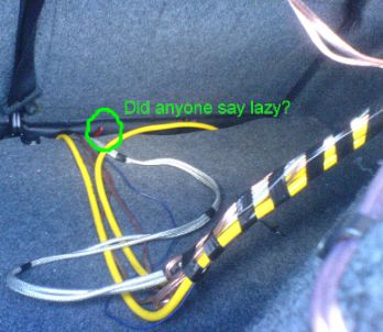

Here for your viewing please, 2 select highlights from the boot install. Please note this is the car minutes after being picked up from a pro installer after I had complained about a dodgy install.
In the first picture...yes that is the rear seatbelt left in the boot/trunk, and the green squiggle highlights the power cable going down passenger side cut at each end with a new one shoved down the drivers side.

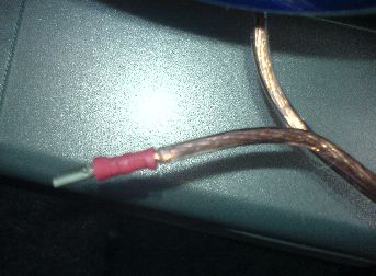

Picture 2....no comment.

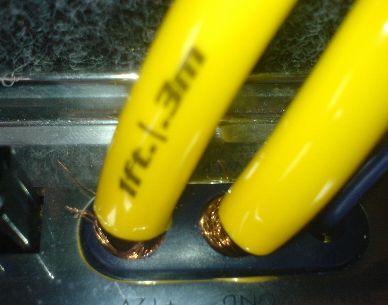

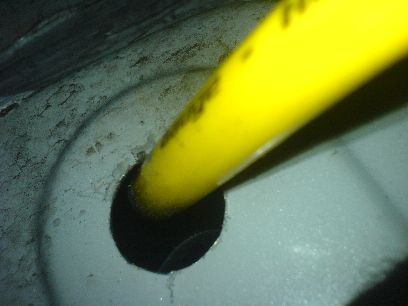

This is the fine work of Technicar in the UK. To quote the website. *ahem* Technicar offers a high degree of expertise in the installation and sale of all audio products...and now here's a bit more of that expertise.
posted_image
I think it needed a bigger hole.
posted_image
Maybe I'm being a bit picky here, but For a company with high degree of expertise...at least learn how to crimp a spade connector.
