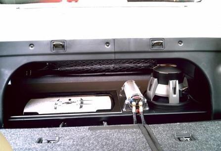

I want to thank you for all your input.  The design I came up with for my box required me to install it with the magnet side out.  Reason being...the box needed to be as flat as possible so I wouldn't lose trunk functionality...
Here's a pic looking from the cabin into the trunk with the rear seats folded down.
posted_image
I asked the question mainly because I'm considering a ported version of this box and I wanted to know if it mattered which way the sub was installed.
One advantage I've noticed over an inverted mount in the sealed box is that no matter what I put in the trunk, no matter how full or empty the trunk is...the bass output doesn't change since it's firing into a defined space that doesn't change, as opposed to if it was mounted regularly and you start filling the trunk with stuff...the bass changes because you're now changing the environment that that sub is firing into.

Posted By: master5
Date Posted: October 30, 2006 at 3:10 PM
Well I would imagine as long as the cone of the sub itself wasn't block it will move the same amount air. Regardless,with all else being equal I don't feel there should be any noticable difference in sound but I do agree there can always be circumstances that might have an affect.
I like your setup and it makes sense utilizing the space you are working with. However keep in mind that depending on the frequency you wish to tune the box if changing to vented will generally require a larger enlosure as well as room for the port. Since your enclosure needs to be so short, slot porting is the way to go. Find out the airspace and port volume reccomended for your sub and take it from there.
Good Luck.

Well...one installer looked at it and suggested that I lift the sub up a little bit by inserting a ring or two to create more space between the face of the cone and the bottom of the box.  The way that box is designed, it originally had approx. .9 cu. ft. (for the Xenon sub), but when I put the Alpine in...it called for about .6 cu. ft.  So...I inserted a baffle that blocked off the section that runs the length of the amp and now it's between .5 & .6 cu. ft.  He suggested that I take the baffle out and let the Alpine work in the .9 cu. ft. space if I want more bottom end on it.
The porting (if I did it) was going to be a simple tube port since I can cut the hole and insert the tube.  The outlet was going to aim towards the back of the seat where there's about 3-4 inches of space between the edge of the box and the actual back of the seat.  That way I don't have to worry about it ever getting blocked.  I think a slot port for this particular box would create too many intricacies in building it.  I'm still trying to keep the slim design.  I might be able to port it running it at the .9 cu. ft.  I'll build a test box and see how it goes.
I do like some of the ideas that were passed on though...aluminum tubing to run the wires through...could add to the aluminum look I already have back there between the amp and the cap.  Now I just have to decide which sub I'm going to put back in there when I get them all repaired.  The Audiobahn is rated at 600 watts, but...a lot of folks seem to be giving Audiobahn a bad rap.  The Phoenix Gold (which lasted the longest of the 3) is rated at 450 watts, but...it loves the bigger enclosure.  The Alpine (500 watts)...well, you see how it looks and it seems to hit nicely.  Now that I think about it...the Alpine seemed to work better when the box was at .9 cu. ft.  It didn't go out until after I took it down to .5 cu. ft.  What you think???
