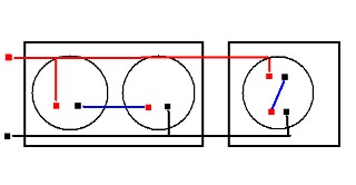

Wiring would look like:
posted_image
This is a series/parallel wiring configuration.  The DVC 1042D would get about the same power as the two 1041s combined, but that might not bother you and it may work out okay when all is said and done.  The load is 4 ohms, so you can use any type of amplifier.  Probably best to use a two channel amp that is rated for bridged output of 600 watts at 4 ohms bridged.  This would equate with a stereo rating of 2 X 300 watts at 2 ohms, so double-check that in the specs.  You can use less power, but no more than this.  And this is RMS output, not "peak" ratings.
EDIT:  I just saw haemphyst's post.  That's interesting....hmm.

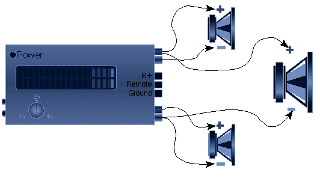

Yup.  I agree with  Dave's wiring.  Disregard the connection between the two 1041s in my pic, and just let the wires exit the box individually for those two woofers.  Here is a wiring diagram complements of BCAE1.com:
posted_image
All else I said about power still applies.

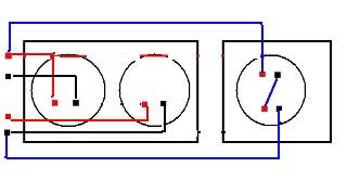

Here's a new diagram.  I fixed it.
